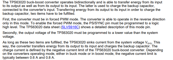

  • Hi Milos,
    Please refer below screenshot for bi-direction application for supercap, do we have similar function for other device?
    Thank you.
    Edward Chen
  • Hi Edward,
    Without explaining the application and the requirements (input/output voltage, load profile etc.) we cannot really suggest anything.
    In general, any other synchronous buck-boost converter with reverse current limit can be used instead of the TPS63020. But for the voltage requirements from your first post, I couldn't find any device that could replace the TPS63020 in a classic supercapacitor backup circuit like the PMP9766.
