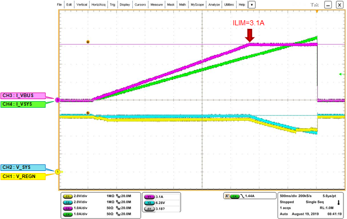

According to my evaluation, the actual input current limit is lower than the setting value if REGN in during the drop mode.
 - Setting value = 3.25A
 - Actual value = 2.8A
The condition is VBUS=5V, CELL_BATPRESZ=2-cells, MinSystemVoltage=6.144V(Default and without BatteryPack.
If VBUS or MinSystemVoltage >7V, the actual input current limit is set to the expected value.
The input current limit is affected by REGN voltage because the the internal ADC doesn't use the ratio metric.
Is my thought correct?
If YES, can you share the data of the actual input current limit during REGN drop mode when the setting value is 3250mA?
