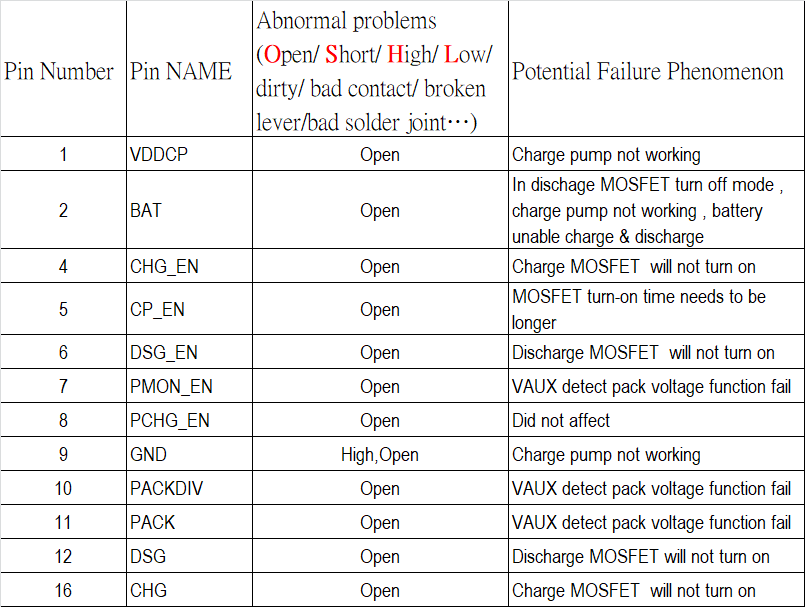

What happens to BQ76200 device if one of the pins had been open from PCB ?
As below is our sugessing , please help me to check " Potential Failure Phenomenon ", and redress them, Thanks a lot.

Hi Went,
The table you are showing is a Pin FMEA. TI provides a Pin FMEA with our automotive devices, but we do not have this type of documentation for devices that are not qualified for automotive. This document takes careful analysis from the design team along with experiments for each case.
The failure conditions you suggest in the table look correct to me, but it cannot be confirmed with certainty without testing.
