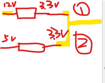

Hi team,
My customer is looking for the solution below to achieve the two 3.3v‘s current are the same. The two 3.3v are connected together. Do you have some suggestions? Thanks.
Frank,
You cannot easily do that. You would be better off to use a single TPS54610 instead. Or you could consider using UCC39002 load share controlers.
