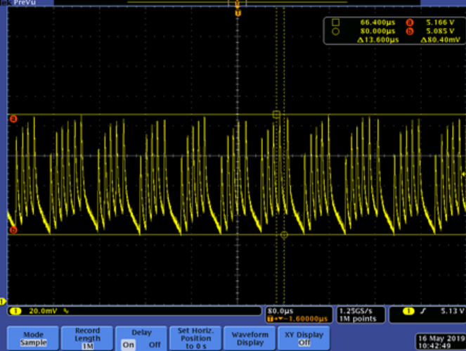

I want to use this device as below, Vin=5V, Vo=3.3V, Io=5A; if I connect 3000uF in the output, will it have any bad impact? Thanks.

TPS54525 adopts D-CAP2 architecture, it has very fast transient response, don't recommend to add large caps at the output, otherwise, there might be multi-pulse issue at light loading. Usually, (2 ~ 5) * 22uF are enough for output cap.
Besides, large output caps will cause big inrush current during output startup, you have to enlarge the soft start cap(cap at SS pin) to enlarge soft start time for reducing inrush current. For 3000uF, you have to use bigger than 68nF for SS cap, the soft start time will be longer than ~9.4mSec.

Thank you for your response here. What do you mean by multi-pulse issue at light loading? If we use 68nF for SS cap, will it have any risk? Thanks.
Hi, Charles
1. The multi-pulse issue: Due to the output caps is too large, IC have to output several switching pulses continuously to charge output, you can refer the below output waveform. (It is from other DCAP2 part, not TPS54525 waveform)
2. Except multi-pulse issue, no other risk.
Suggest to use SS cap=100nF for smaller inrush current.
