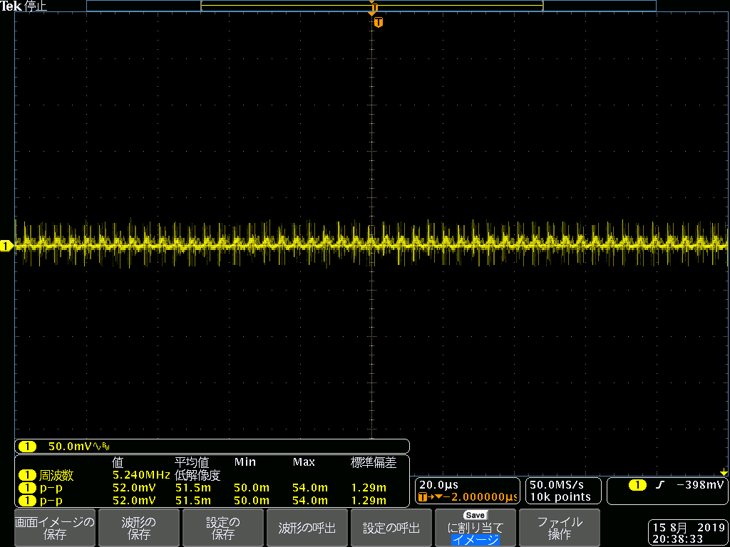

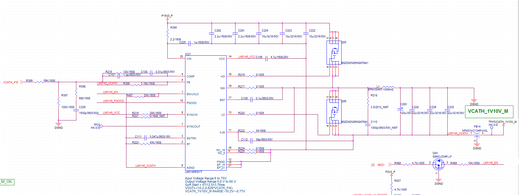

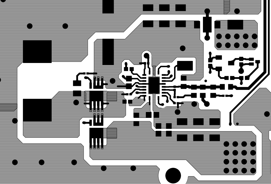

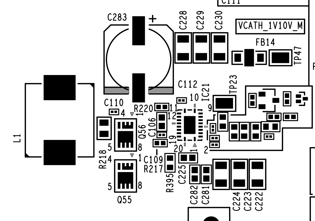

I would like to ask that the LM5145 to do a positive 15V voltage conversion into output voltage negative 5.5V voltage( a DAC to adjust ), at the current 1A output, the output waveform is terrible, may I ask what is wrong.
Adding Attachments:photos of schematic and output waveforms, layout screenshot

    Also, please refer to the PCB layout guidelines in the LM5145 datasheet. The input caps in your layout are too far away from the FETs and route the switched current under the controller. The layout of the LM5146-Q1 EVM has a similar FET arrangement - please refer to that layout for recommended input cap placement.

    Note that you can measure the SW node voltage to check that the converter is stable. If the main issue is noise and spikes on the output voltage, then I recommend connecting a small 10-47nF cap near the FETs from VIN to GND, i.e. from drain of high-side FET to source of low-side FET. This reduces the switching loop parasitic inductance and thus the SW voltage ringing (which can propagate to the output via the parasitic capacitance of the inductor).
    Also, you can add an output capacitor after the ferrite bead to improve the high-frequency attenuation of that filter stage.
