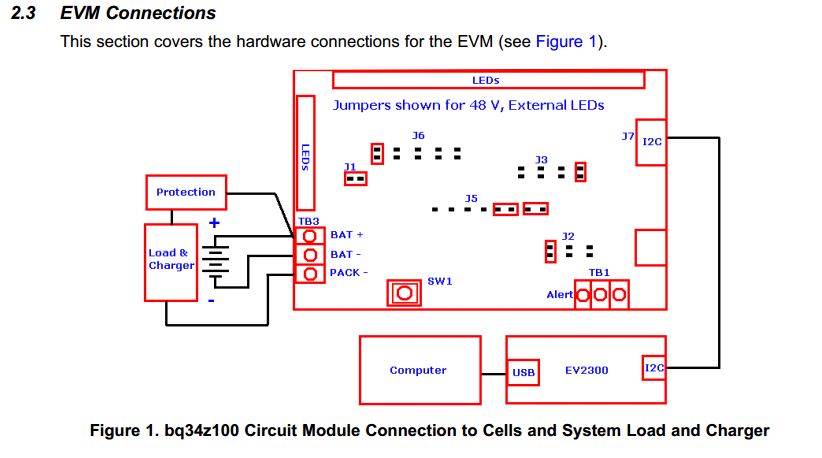

Hi Experts,
I have started working on power management solution for one of our product,
there I'm willing to use Bq34z100 G1.
So on very first step of generating the golden image.
i have found this H/W connections on EV2400 user guide.
I would like to know which type of protection circuit here required with the charger/load..?
just a fuse or any other specific protection circuit of TI or what or it can be left as optional.
moreover may i have some guides to step by step procedure of generating the golden image,
for Bq34z100 g1 using EV2400.
and this current, voltage and temperture calibration is prier steps of charging discharing cycles
one more query like after successful generation of  golden image, how can i burn the same in other Bq34z100G1 chips left in spare.
  • Hi Sanjay,
    You will typically need a fuse with this gauge and a smart charger that knows how or when to stop charging.
    We have technical documents available in the bq34z100-g1 page. Please refer to them for help. For running a learning cycle, please refer to the attached document. 6675.SLUA925_bq34z100-G1.pdf
    You can export the golden srec from a learned pack and use that on other production packs.
