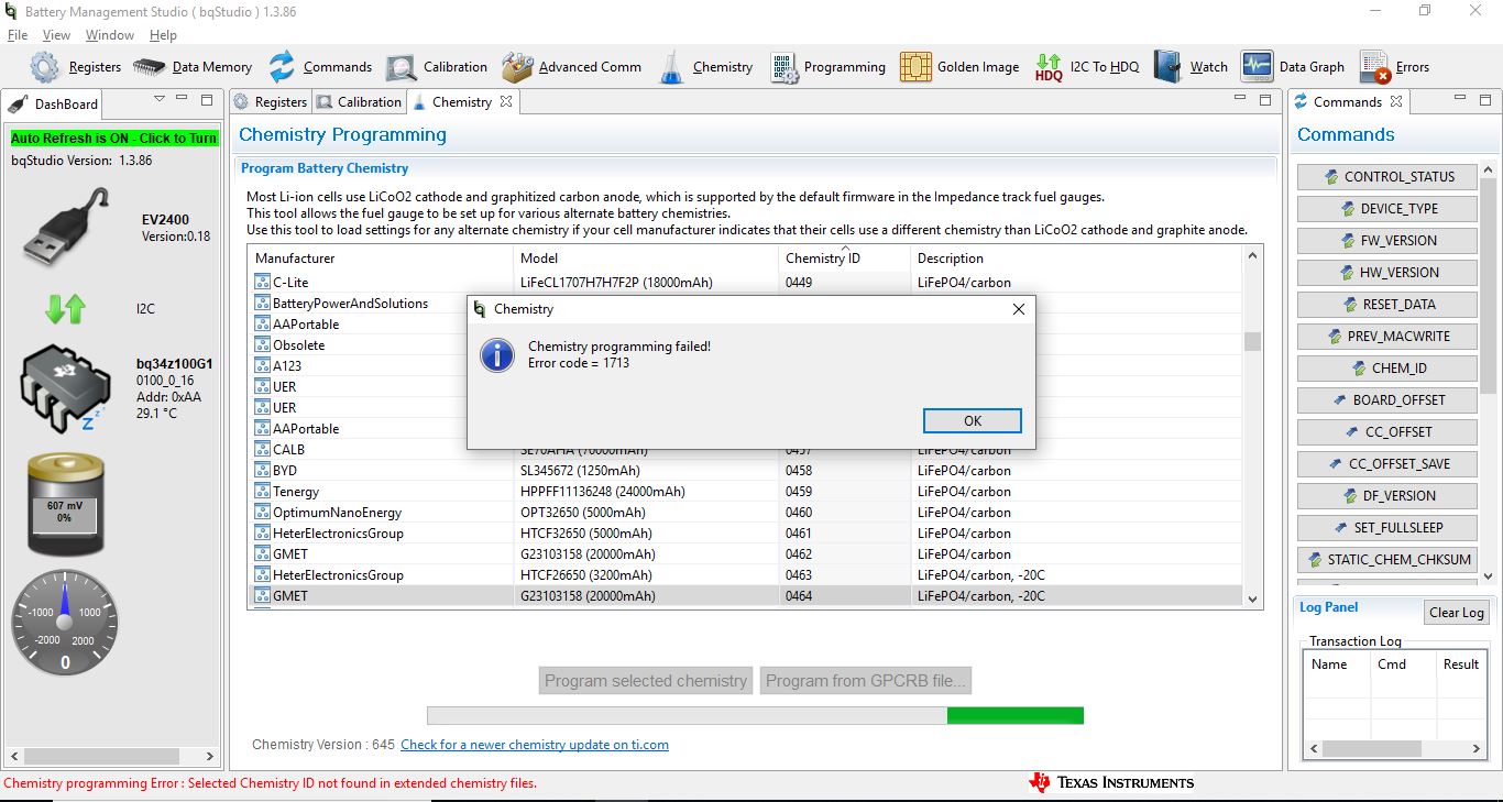

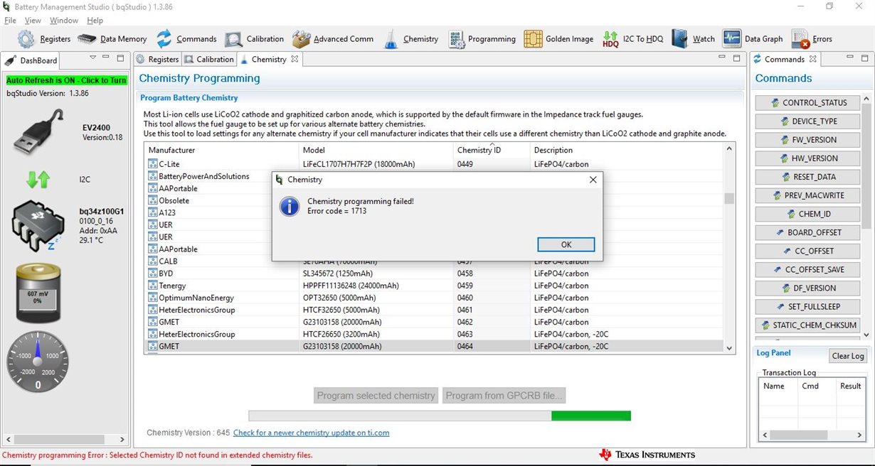

  • Hi Sanjay,
    Please find the chem ID update here, . Download the zip file. Then go to bqstudio, click on help, update chemistry, cancel, then select the zip file and update the chem database. Once you do that you will have the data to program the ID here.
  • Hi Batt,
    Thanks for the chem Id database, the database is up to date now,
    but issues of updating chem id remains same,
    On updating from the GPCRB file, error code is 1713 "Chemistry Programming failed"
    On updating from the available list of chemistry, Error code is 1470  "Chemistry Programming failed"
    even I have tried reinstalling the BQstudio, updating chem database again but the same problem persists.
  • Please check if your device voltage reading is correct and that your dividers are in the correct position on the evm. Then please make sure that your voltage is higher than flash update voltage in df. That should resolve the issue.

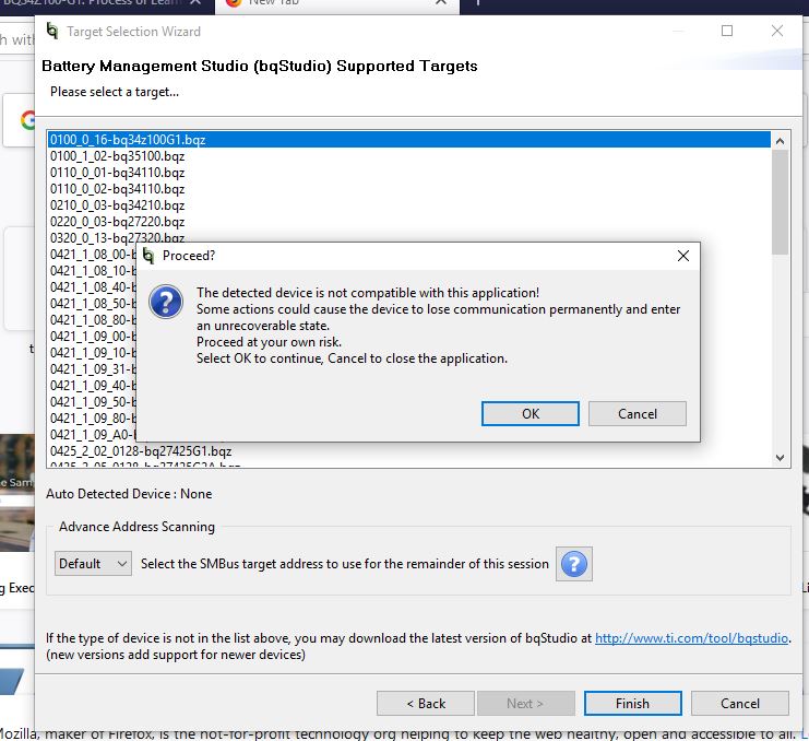

    1) Every time I open the BqStudio, I receive a warning popup window, screenshot attached "WarningPopup"

    3) I have tried updating chemistry with a new EVM board, it's done without any error, "Chemistry updated successfully"
    so I would like to know what that error meant for Error No. 1470 and 1713, how could I repair the board if any h/w fault is there?

  • Hi Sonu,
    The first thing to check is your divider. My suggestion is to set it to <5V and 1s config if you are using the evm first time. Then use that to update the chemistry table. Once you have done that and updated the gas gauging parameters, then you can go ahead and set the appropriate divider and then power up the gauge. Following that, please perform the learning cycle per the document attached here, 5773.SLUA925_bq34z100-G1.pdf. This tells you the config options for different chemistries. For performing a learning cycle, you can follow . Though it's for a different gauge, the general principle applies. Further help can be found in technical documents here, http://www.ti.com/product/BQ34Z100-G1/technicaldocuments. Your errors may be related to the voltage divider not being set correctly.
  • Hi Batt,
    Thanks alot for the kind assistance,
    I have changed the voltage dividers on <=5, and the ChemID is updated successfully.

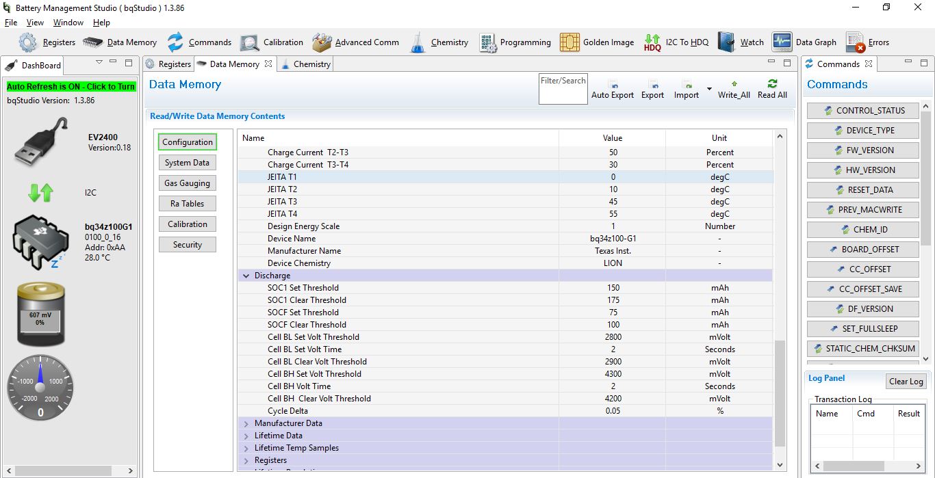

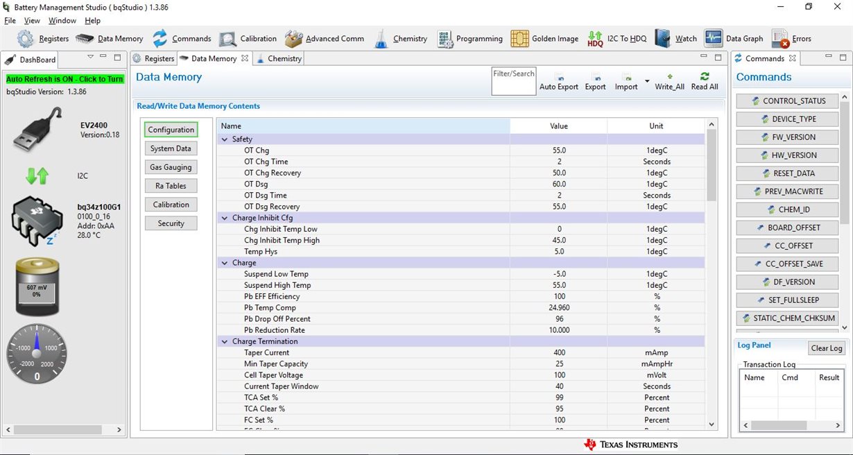

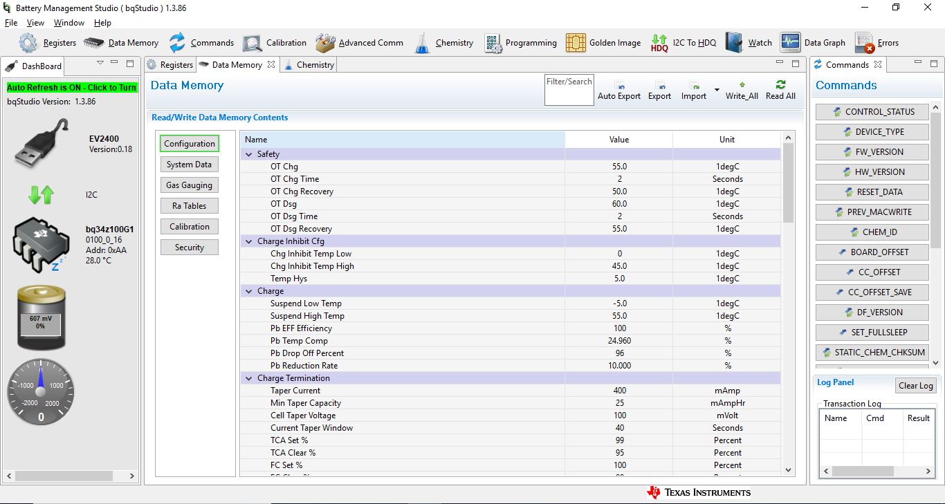

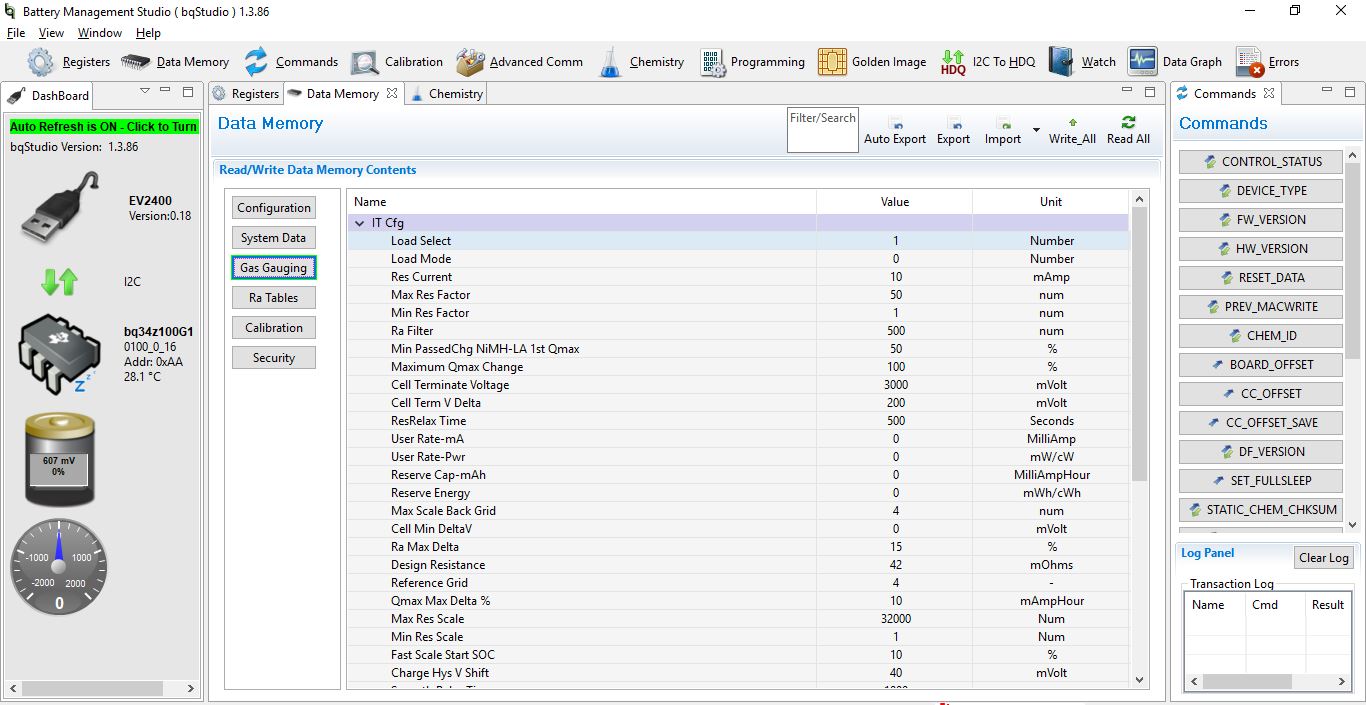

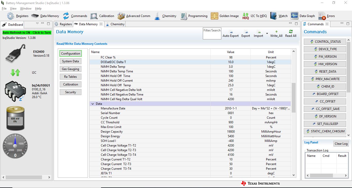

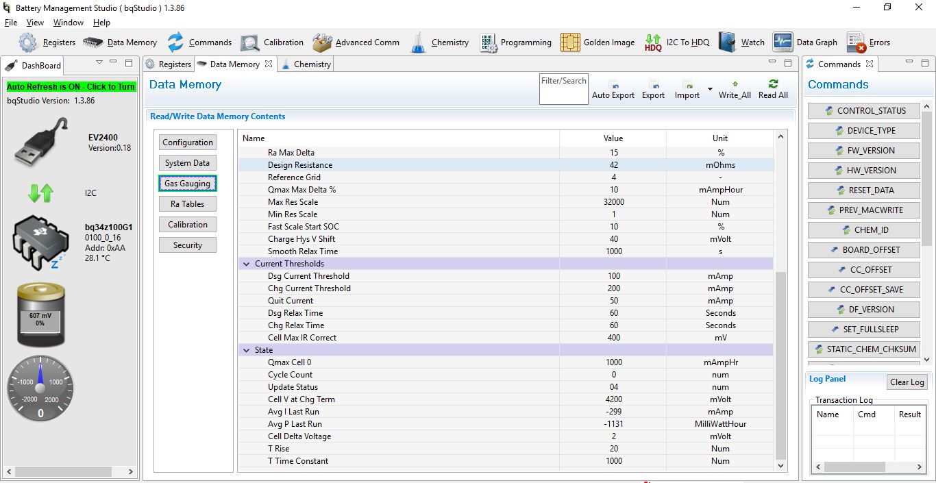

    Now as on the second step I have to edit a few parameters of Data Memory
    I have found few parameters under configurations and Gas gauge tab of DataMemory(Design Capacity, taper Current, Dsg Current threshold, Chg current threshold, quit current threshold).
    but a few are creating confusion, like where to fill
    Design Voltage, Term voltage? is Cell termination voltage is the synonym of Term Voltage?
    and what should be the value of design Energy?
    secondly, I have to left other parameters unedited like
    Cell Charge voltage T1-T2 4200(default value)
    Cell Charge voltage T2-T3 4200(default value)
    Cell Charge voltage T3-T4 4100(default value)
    same Charge Current btw T1-T2, T2-T3, T3-T4?
    but these parameters seem to be set for 5v battery,
    So I'm attaching screenshots of data memory.
    Please have a look on Screensot shared,
    Thanks in advance
    SoonuVerma
  • Hi Sonu,
    Please read through the fundamentals of gauging,  and also refer here, https://e2e.ti.com/blogs_/archives/b/fullycharged/archive/2016/03/02/how-to-run-a-learning-cycle.

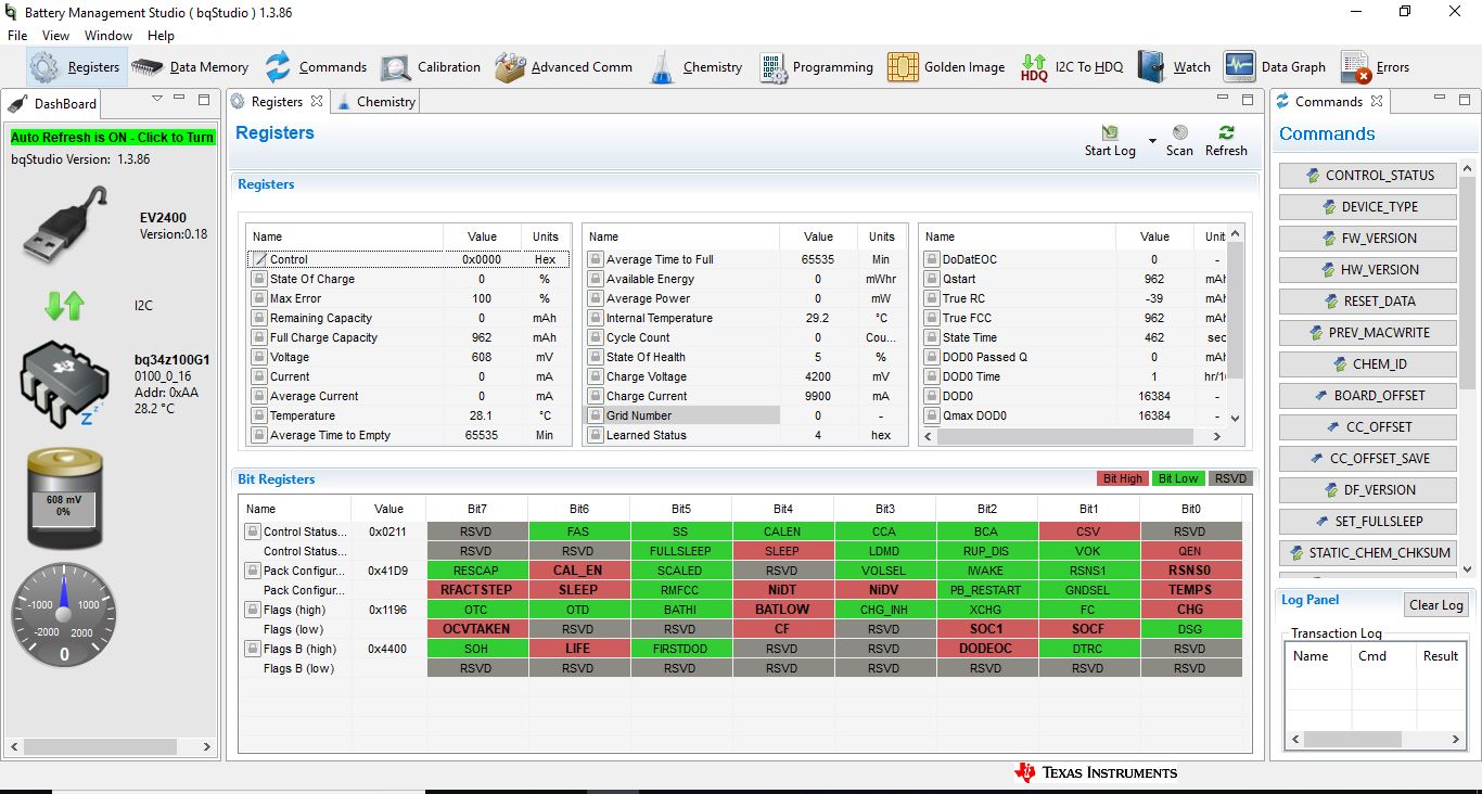

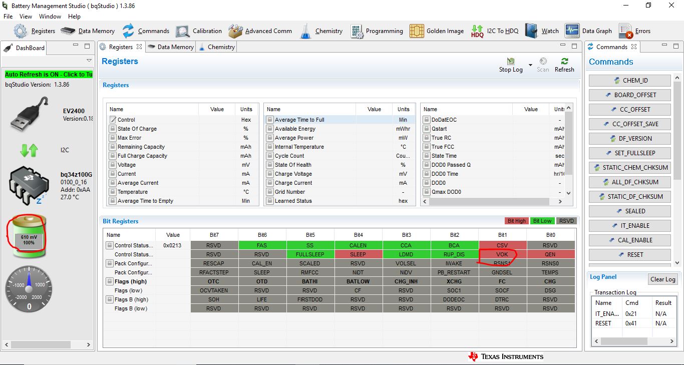

    I have gone through the documents, and started the learning cycle,
    first discharging cycle was accomplished with C/10 load, then after 5-6 hours of rest period after completion all registers are updated as mentioned in the doc,
    so started charging as the second step,
    during charging cycle for a moment Bqstudio displayed USB not connected, so I tried to refresh the dashboard but nothing happens so I plug out and plug in the USB. connection established but few registers shown as RSVD, ScreenShot attached.
    After charging cycle and 2-3 hours of rest, update status should be 05 but it's still 04, RUP_DIS is clear but VOK is still high whereas VOK should go low.
    So I would like to know should I proceed with the next step of "discharging the battery" with default values or manually change update status to 05 and proceed or REstart from the beginning.
     or restart the process as something gone wrong.
    moreover, I have one more query regarding the icon of battery in dashboard why it always shows near about 596mV to 610mV, SS attached.
    Regards:
    Soonu Verma
  • Hi Sonu,
    You need to have the dsg at a rate higher than C/10. A C/5 or C/2 rate is preferred. Once you do that, your parameters will update correctly.
