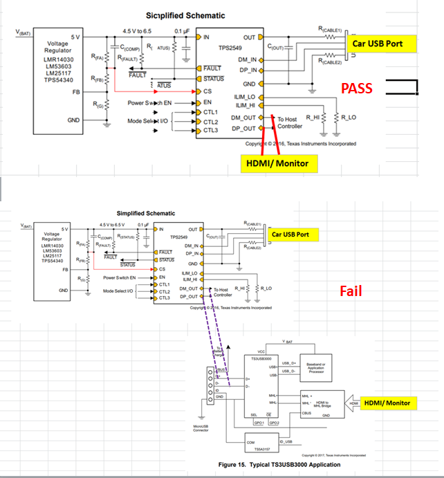

My customer use TPS2549-Q1 EVM to do test, it can detect phone..
But if TS3USB300 + TPS2549-Q1 can't detect phone.
Please you kindly review & help advise.

Hi ,
Do you have any schematic for review ?
Hi Steven,
Have you set the TS3USB3000 correct ? Is the TS3USB3000 be enable ?
If you can provide the DM_OUT ,DP_OUT , IBUS, VBUS waveform for analysis is helpful. How you set the tps2549 mode , in CDP or SDP ?
How you connect this two board, thanks!
