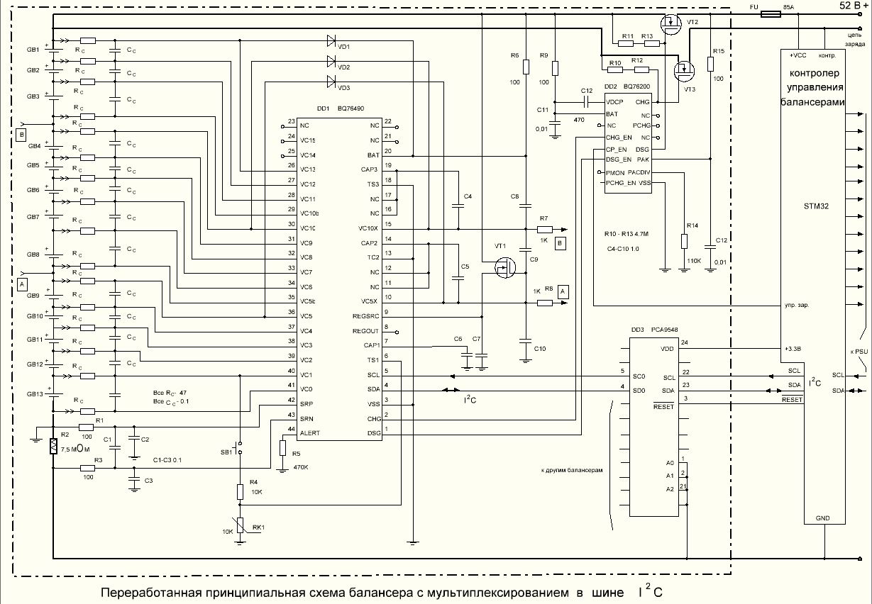

    Wrong drawing of the wiring diagram for the last time. Here is the circuit diagram I'm going to use. The question is the same. Is it possible to use recommended BQ76200 with the controller for switching of the sections keeping control of individual balancers?
    By switching the transistor using the CP_EN output?
    Regards, Dmitry
  • Hi Dmitry,
    CP_EN can be used to control the FETs. However, there are a couple of things to keep in mind regarding this:
    - The charge pump is enabled if CP_EN is high or if CHG_EN or DSG_EN are high. Even if CP_EN is held low, the charge pump will turn on if one of the FETs is enabled.
    - The charge pump turn-on time is slow, ~100ms according to the datasheet. It is generally recommended that CP_EN be set high once at system startup for most application. I understand your application is unique.

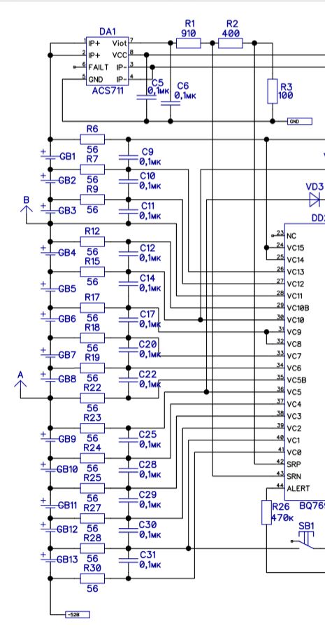

    I want to measure the current with a current sensor. The current sensor is in a +52 V power bus rupture. The signal from the current sensor will be scaled to a voltage range of +-200mV. I understand that the measurement accuracy will be reduced. I want to know if a 16-bit ADC can measure current under such conditions.
    Regards Dmitry.
  • Hi Dmitry,
    Some other users have implemented a hall sensor into their design successfully. The accuracy will vary over temperature according to the ACS711 datasheet, but it might be okay for your application.
    Some important things to consider:
    • The input voltage of SRP and SRN should stay within the datasheet input range (+/-10mV for SRP, +/-200mV for SRN).
    • Make sure to review the Design Example walk-through in section 11.2.1 of the datasheet. In this process you need to consider the current detection levels for over-current protection and short-circuit protection.
