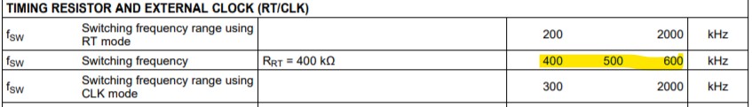

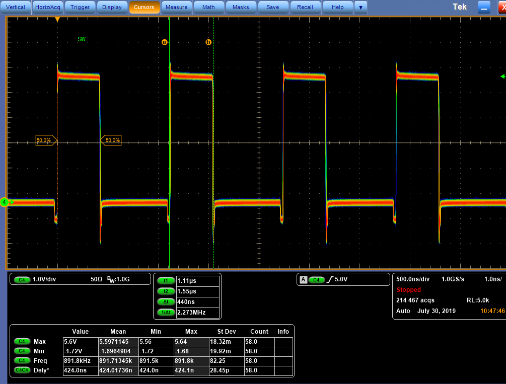

My customer is using the TPS54318 now and set the RT =178k(±1%), so the switching frequency should be 1.03Mhz, but the real frequency is 890khz. Whether it's a normal thing. based on the datasheet, it seems to be normal. Thanks.

Frank,
Yes, that is within the specified tolerance.
Hi John,
Do you know how many variation is normal? For example, +-20%. Thanks.
