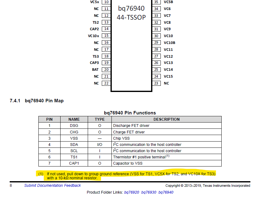

1 In my application design, I don't use any of the 3 temperature sensors
As they are not needed in our circuit. If not, it should be left floating or grounded?
2 We don't need MOS driver charge/discharge protection. The outcome Over Voltage will affect the stability and performance of BQ7694003?
