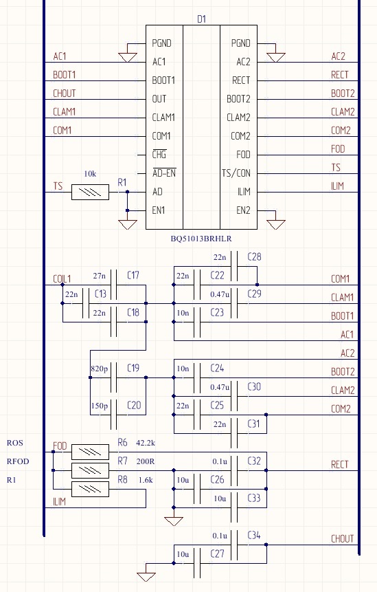

Hello! My costom board based on BQ51013B works fine with various Qi charges of a large (6-8cm) diameter, but refuses to work with small-sized (diameter) ones, such as charging for Apple Watch and others. What could be the problem? I use small charge coil 760308101214 (https://katalog.we-online.de/pbs/datasheet/760308101214.pdf).

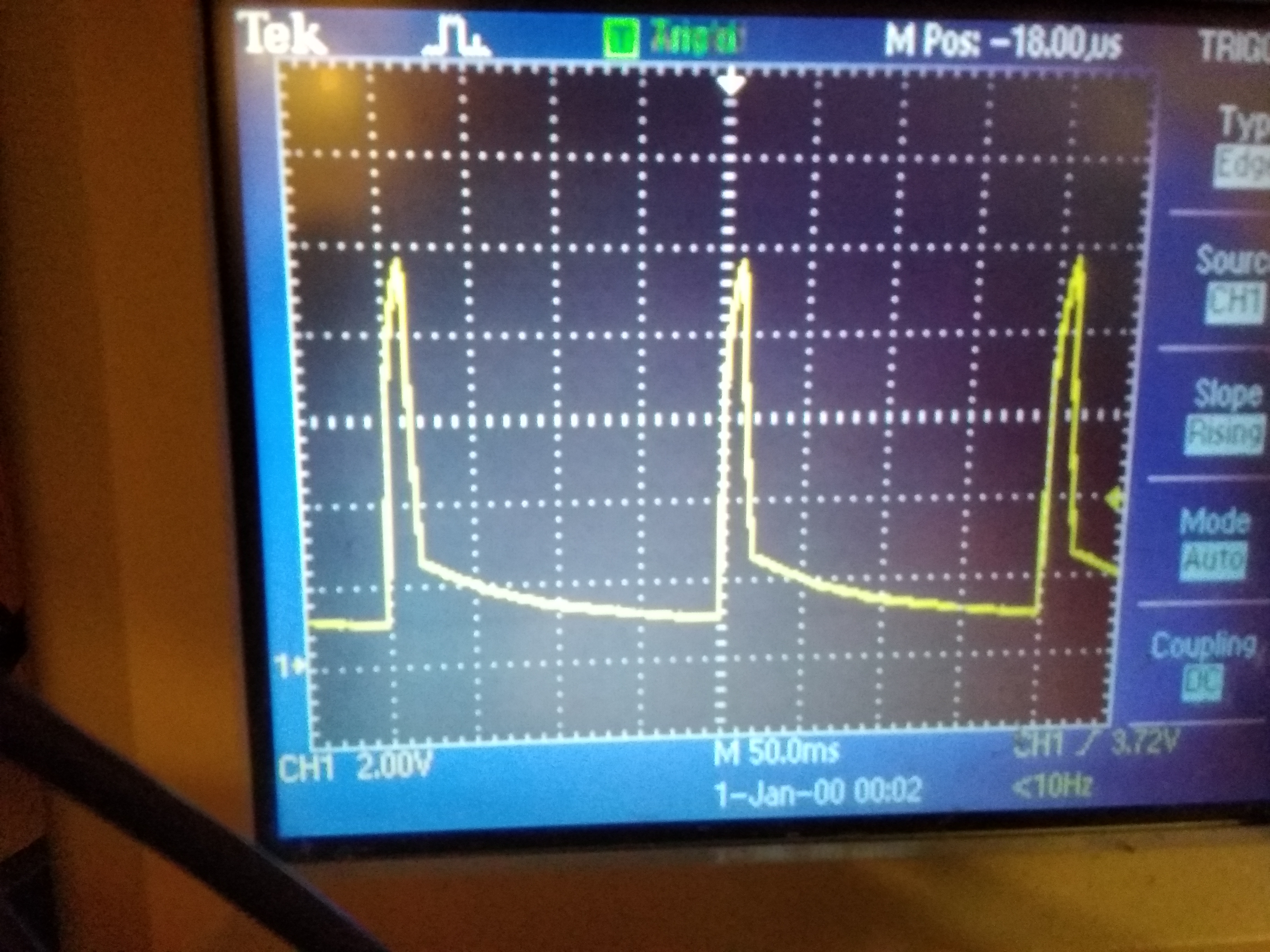

  • Bill, RECT rise up to ~10V every 200ms. Is it right behavior? Need i tune coil? If NO why my device did not charge from little chargers?
  • The voltage looks high enough to start and voltage is below OVP (15V).
    RX should try to communicate with the TX, should see modulation on the RECT about 40mS after the voltage goes above UVLO. See attached.
    Tuning could still be an issue, L of the 760308101214 is double the typical coil and Cs caps would need to drop by 50%.  Once this is doe the comm1 / comm2 value may be too high.

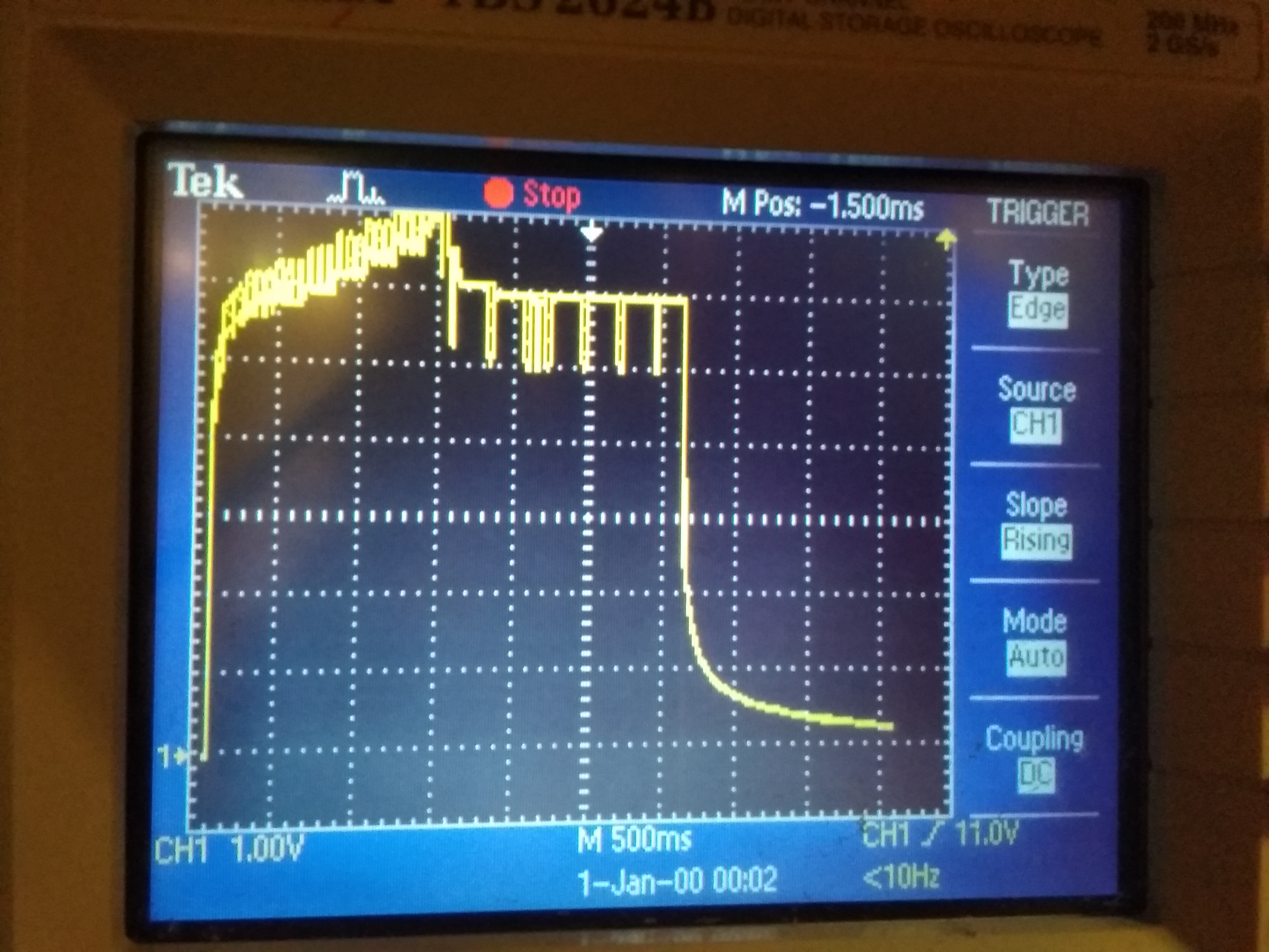

    Now I see the next waveform on VRECT. Why does VRECT drop down after 3 seconds?
    When I wrote about 0.5s, I looked at a regular multimeter and therefore could be wrong.
  • What could be happening.
    After the RX sends SS/ID/Config the RX will start tuning TX operating point to 7V at RECT.  That is what we seen in the first 3 divisions (1.5 sec).  During this time the output is OFF, no load.
    At 7V the output turns ON and load is applied.  We see the voltage drop.  That is the next 1.5 sec and then TX turns off.
    What is causing the TX to turn OFF -- one clue is 1.5 sec, if the TX does not receive a Control Error Packet (CEP) is 1.5 sec it will restart.  The other thing we see is the operating point is not changing, RECT voltage not changing for last 1.5 sec.  This points to a communication problem, the TX is not decoding the CEP.
    What are you using for Comm 1 and Comm 2 capacitors?
    Do you have a schematic you can send?
  • Bill, COMM1 = COMM2 = 44nF . Is it right values?
    //Do you have a schematic you can send?
    Yes but there are no nominals. ok I'll make schematic with nominals.
  • This looks a little high.
    Try sizing the Comm caps to 10% of the Cs caps. This would be the caps in series with the RX coil and tuned to 100kHz.
  • Hello, Bill! Oh, i.e. shuld I remove C28, C31 and change C22, C25 to ~7.1u ?
    Are other components compatible with 760308101214 (L = 26 μH, DCR = 520 mOhm, L '~ = 35.6 μH)?
    I calculated for this coil Q = 314, and capacitors 71n and 975p. Are these the correct values?
    You also wrote earlier:  //L of the 760308101214 is double the typical coil and Cs caps would need to drop by 50%.

    I also attach part of the circuit with BQ51013B:
  • Hello
    Should I remove C28, C31 and change C22, C25 to ~7.1u ? Bill J -- First try removing C28 and C31, if that does not work try 7uF.
    Are other components compatible with 760308101214 (L = 26 μH, DCR = 520 mOhm, L '~ = 35.6 μH)? --- Bill J -- Looks good
    I calculated for this coil Q = 314, and capacitors 71n and 975p. Are these the correct values? --- Bill J -- Looks good
    So are 760308101220 with L=12.6uH and R=340mOhm is better than 760308101214 choice? -- Bill J -- 214 with higher L should be better.  As coil size goes down then coupling factor goes down.  To off-set this increase coil L.

  • Also
    Double check the coil connection --- COIL 1 is in the right spot
    But did not see COIL 2 connection.
  • Hello, Bill! Sorry: Coil 2 connected to AC2 (according to Simplified Schematic of datasheet).

    //Bill J -- First try removing C28 and C31, if that does not work try 7uF.
    Without C28 and C31 VRECT drop after ~3s. Even with C22 and C25 equal to ~7nF VRECT drop after the same time.
    This is occur with and without load (0mA, 10mA, 80mA).
    May be problem in Ros, Rfod or R1 resistors?
  • Hello, Bill!
    Even decreasing ROS to 20k does not help...
    Oh! I see the difference betveen my VRECT signal and signals from other developers: https://e2e.ti.com/support/power-management/f/196/t/721489?BQ51013B-BQ51013B-Problems-with-initialising
    At digital transmittions my VRECT level decrease.
    For others, it is increasing. Is it problem?
  • The change during communication, Buck (decrease) or Boost (increase) will vary with load and tuning.  It is common to see a boost at light loads then at higher loads it changes to buck.
