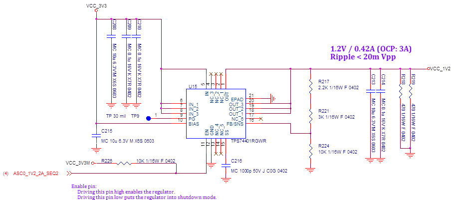

Dear Team,
Do you have further comments for this design?
BR
Kevin

Hello Kuan,
Overall the schematic looks good.
There is a note which specifies that the ripple will be less than 20mV pk-pk.
Without an input ripple spec, I cannot assess that the design will meet the 20mV pk-pk output spec.
