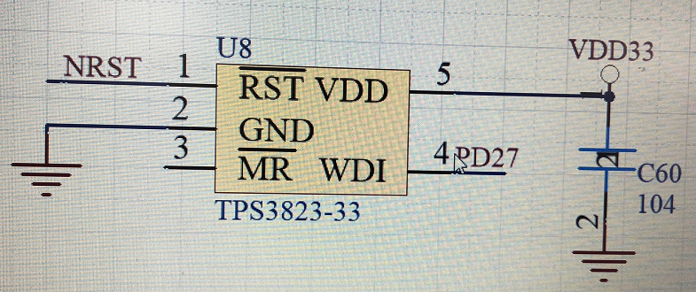

TPS3823: TPS3823-33DBVR abnormal work
Part Number: TPS3823

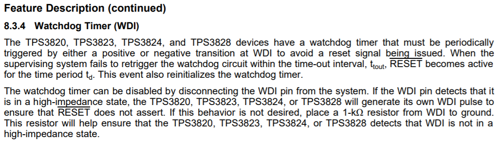

If the TPS3823-33DBVR WDI pin remains low, what voltage does Reset output? Why did I actually test that Reset has always been a high-level output? Understand from the specification that if there is no signal jump in WDI during the corresponding period, Reset should be low level output.
