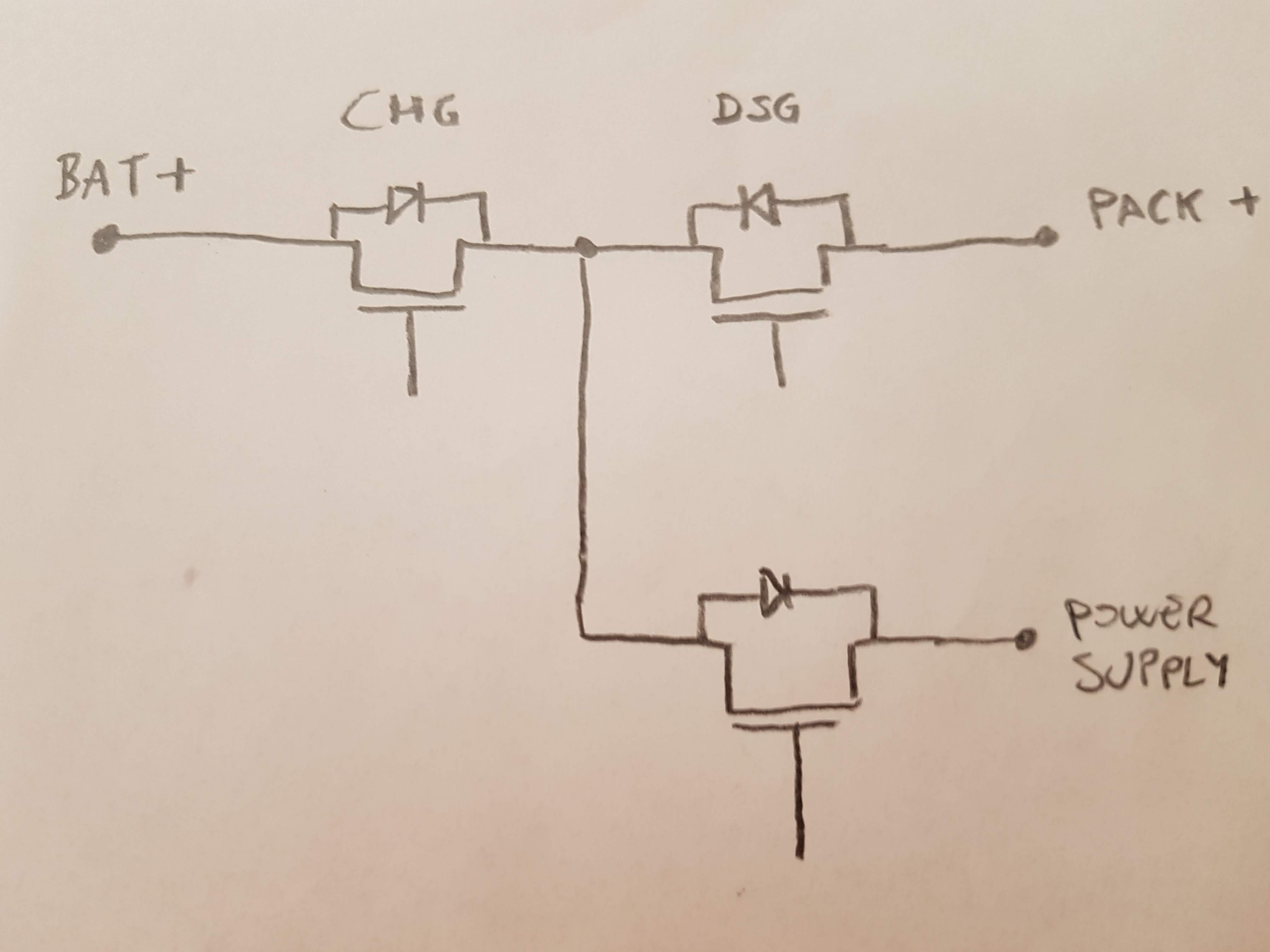

  • Hi Matt, thank you for the reply.
    Since I already have a microcontroller on the board for wireless communication, what do you think about the possibility to turn a mosfet placed from the power adapter positive terminal and the central connection of the CHG and DSG fet when the power suplly is connected? This should cause the BQ78350 to turn on the DSG fet too, but I don't think this can cause problems.
    The circuit should be like this:
    Stefano
  • Hi Stefano,
    I think this could work. However, it really depends on how your system operates.
    During discharge, the body diode protection will sometimes turn on the CHG FET. In some applications this could be an issue because the charger contacts are exposed and could cause a safety issue. I think your proposed circuit solves this issue.
    During charge, the body diode protection will sometimes turn on the DSG FET. In some applications, the load is never fully off and this might be an undesired behavior while charging. Hopefully this is not an issue for your system.
    Matt
