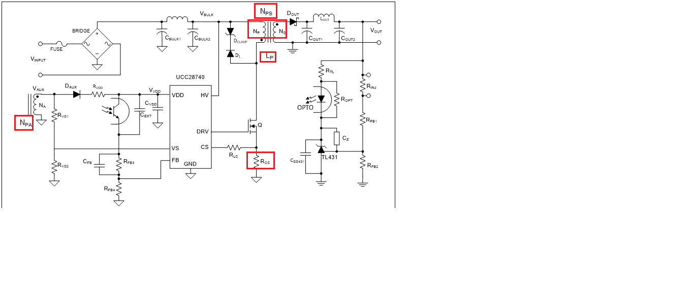

    4. Base on RD input SPEC and notice red word , as below picture , please help to analysis which cause VDD voltage follow load transient rise but not yet
    setup max load 1.5A , Vdd voltage already on maximum ratings ?

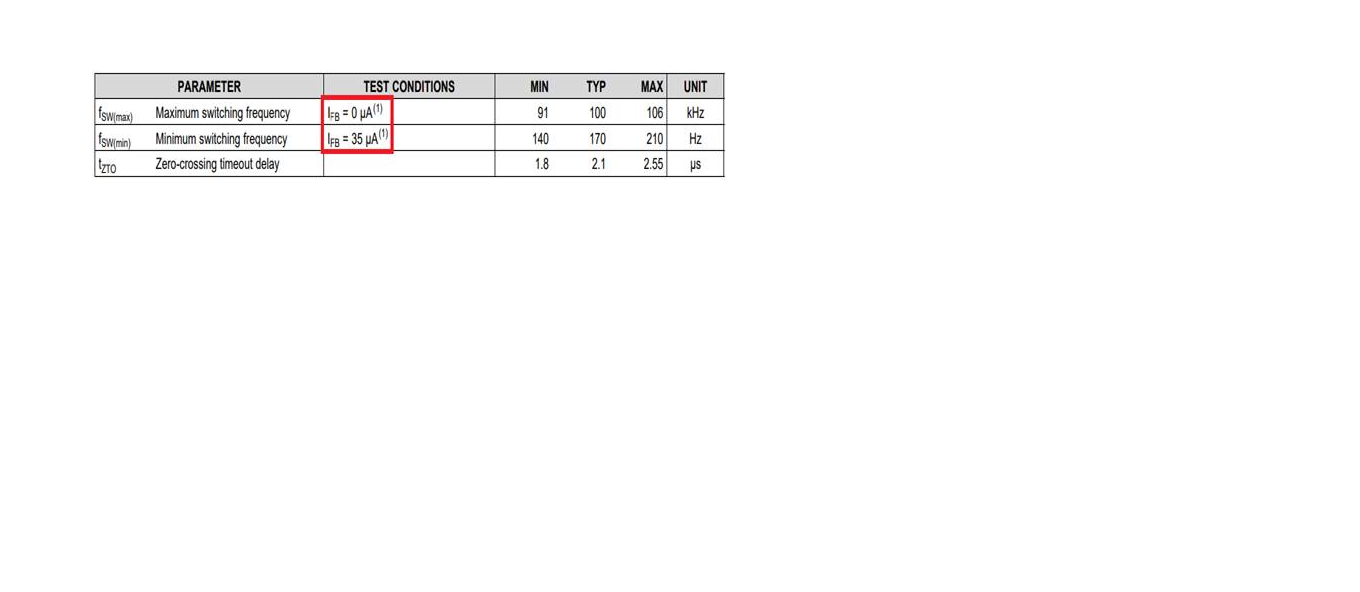

    5.How could we setup frequency run up to 60~65K Hz ? setup form Cfb ?

  • 1. If you pick up a turn ratio Nps lower, you will see several influences on the design parameters. Deep DCM is the most critical one to mention. If you fill in an arbitrary turn ratio you need to see what changes in the calculator to see if these changes are ok for you before move to the next fill in.
    2. Yes, it will get Iocc smaller.
    3. If Lp is smaller than recommended, the peak current may become always greater than needed during leading edge blanking, which will result in output over voltage protection.
    4.VDD voltage should be regulated by output voltage by turn ratio Nas of aux to secondary. Please make sure the turns ratio correct. You may use an oscilloscope to monitor aux winding output to check the turns ratio Nas correct or not. One possibility is your aux winding has too much leakage. In this case, you need to reduce leakage. Other less effective fix is to increase Rvdd. Or if you want to you can add a Zener clamp. One more thing is to check if you transformer polarity connected as assumed.
