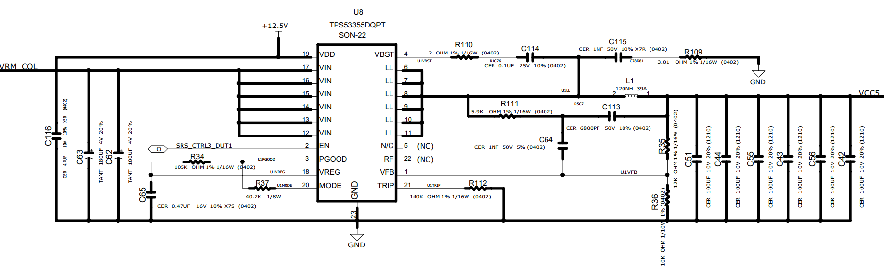

TPS53355: I see large switching spike from our setup using model specs
Part Number: TPS53355
We have a setup using the model in WEBENCH. The setup we have is 1.9V input to Vin and we are outputting 1.35V. Current max is 20A. For the inductor we are using 120nH (VSLC7649S-121KLB)
and 6 100uF ceramic caps (LMK325BJ107MM-T)

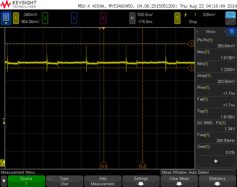

We see the large spikes from the scope when measuring near the Vout with very short gnd. The spikes we see are reaching about 500 to 600mV.
Wondering if this normal to see with this setup and if any improvement can be made?
