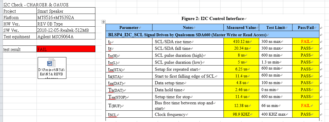

BQ27520-G4: I2C t(BUF) bus free time spec too big (66uS)
Part Number: BQ27520-G4
we planing to use a common I2C bus as 400KHz clock speed for gauge IC and others accessories, The bq27520 spec shows it can support high speed clock up to 400KHz but bus free time spec is 66uS(min), does it correct? the I2C spec should be 0.5uS (min), please help to confirm does spec correct? and can bq27520 work on 400KHz I2C bus clock? why the gauge IC bus free time spec so big?
