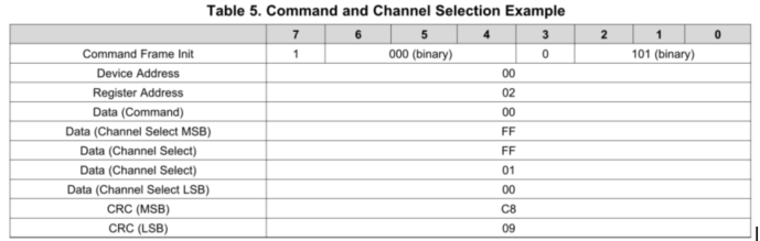

    2. It's all depends on conversion time and how you convert and read. 1. You can do convert and read the registers or  you can do write with responds. So let me know how you are performing this.
    I want to get the information of all ADC channels. I think the packet like below but with all channels are selected.
