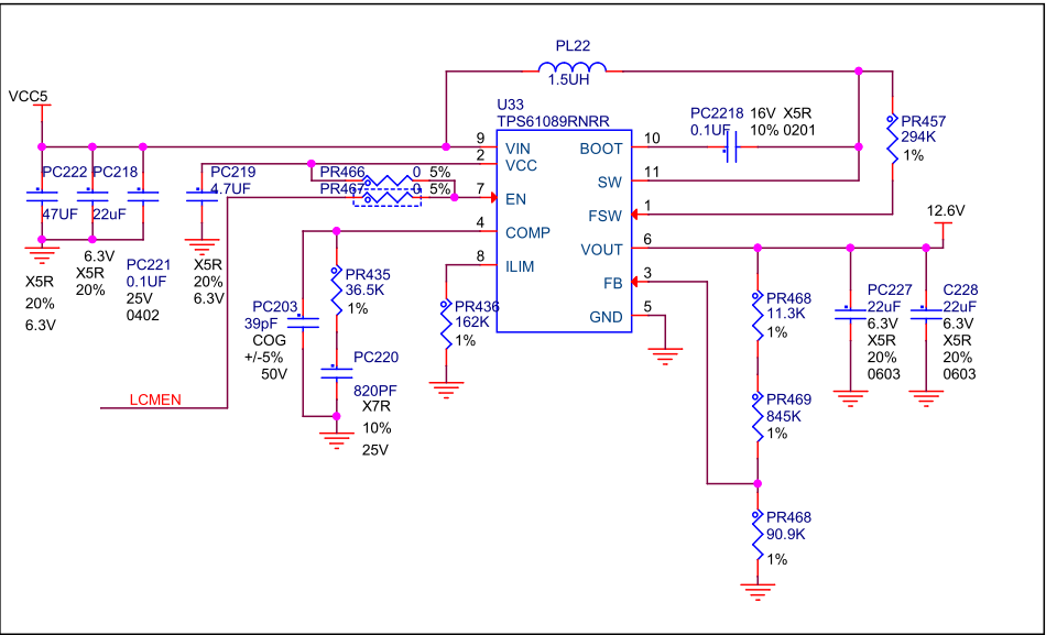

Dear E2E,
please help to review the schematic below.
5Vin to 12Vout/1A
BR,
Jason
Dear Sir,
Here's review result:
1. change the output cap to 25V/22uF one. current 6.3V rating will got damaged ;
2. change PR457 to 255k to set the fsw=600kHz;
3. Compensation network: Rcomp=10k/ Ccomp=10nF/Cp=47-100pF
