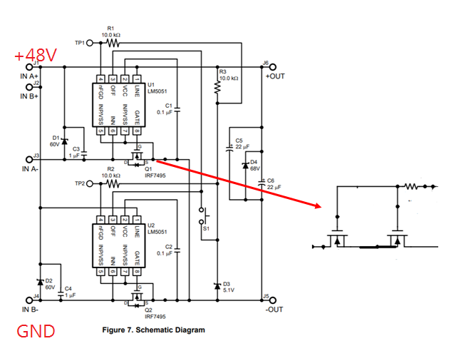

I saw LM5051 EVM, about MOSFET may I design a back to back MOSFET structure?

With LM5051 linear regulation scheme, it will need more discrete (which we have not tested, no results to share yet) circuitry around LM5051 to control two back to back MOSFETs.
However we suggest TPS23525 or TPS23523 which control ORing and Hotswap back to back FETs for -48v application.
Could you please have a look at this device and let us know if it works for your application as well?
