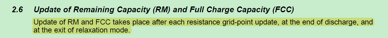

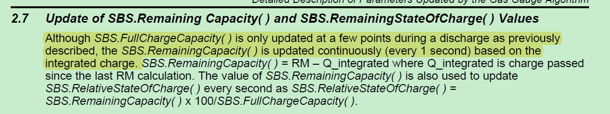

     In SLUA364B, there are different description on when RM update.
They are inconsistent. So I want to know when RM update, in relax, charge or discharge mode? How does RM update in different modes? Because I also notice RM does still change during charge or discharge mode.
