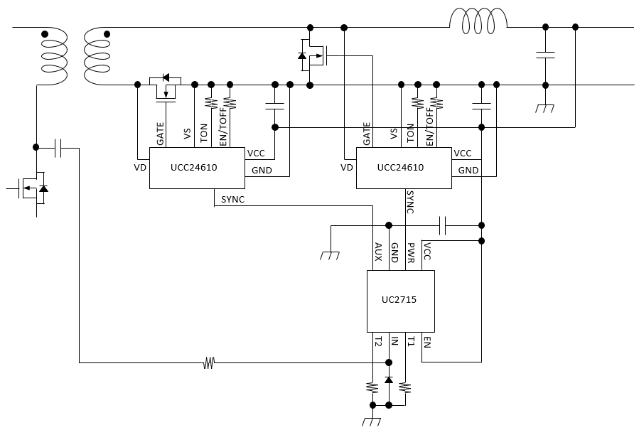

Hello E2E,
I came up with full secondary side synchronous control using UCC24610 by see fig.23.
I drew the simple schematic, please see it.
We necessary dead time settings firture because reduce the shoot through current.
I thought that use UC2715 or TPS51604 for gate timming contlorl would reduce the shoot through current.
Pulse trigger is Drain voltage of primary side FET.
Does TI concerned about this usage?
Please specialist opinion.
