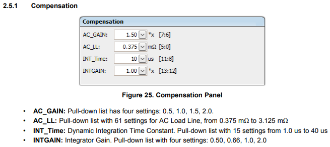

Could you please provide the detail description about compensation setting and workflow of "Fusion Digital Power Designer"?
The  introduction in "User's Guide SLUUBL0" is too simple.
In addition,
When start up, will the compensation parameters be automatically adjusted?
