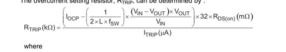

Hi team,
Do we have more accurate formula to calculate the TPS5335 RTRIP, the formula below isn't very accurate. Thanks.

Frank,
The datasheet formula is the best that we have.
