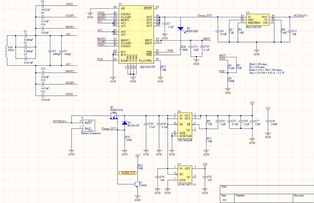

I'm designing a circuit using wireless charger BQ51003 and I would like to be sure that I designed it correctly. Here is the circuit:
When battery is charging, microcontroller will sleep.
Do you recommend me to add something?
Thank you very much,
Jorge
  • Hi Jorge
    See below check list for schematic review.   TS_CNRL (F1) needs to be 10k resistor.
    Also for layout use TIDA-00318 and TIDA-00669.
    Things to check on your design:
    1. Pin out of symbol, make sure it matches device
    2. AD pin ground – if adapter option not used
    3. COMM, BOOT, CLAMP and AC – Recommend reusing values from EVM / Application section
    4. PGND connection -- verify good connection to ground
    5. ILIM pin connection to ground thru FOD resistor -- verify current limit set point
    6. FOD pin connection, 196 ohms good value to start, tune during fod cal
    7. EN1 / EN2 Pin ground -- recommend adding 0 ohm to give you options
    8. CHG pin LED, Open drain output
    9. TS / CTRL Pin connect to gnd with 10k, safe condition good
    10. RECT pin (AC1/AC2 full wave rectified signal), Cap bank to filter signal --- max voltage could be 15V to 20V.  Note R20 value set during fod cal, 20k OK to start.

  • Hello Bill,
    Thank you for the answer. Attached below how it looks like:
    Thank you for the support!
    Jorge
  • Hi Jorge
    The BQ5103 circuit looks OK.
