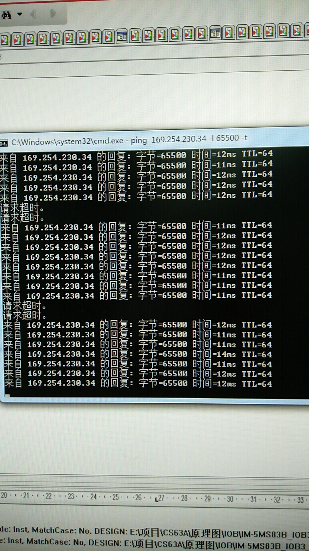

When we use the TPS2372 POE to supply power, there will be packet loss when the network cable is 100 meters ping packet test.
When we switch to DC24V, it is normal.

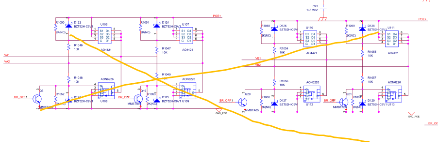

Hi Vickers,
You may want to check your PoE PD front end filtering and layout. Usually there is an EMI filter after the diode bridge to reduce the noise from the DCDC converter to the data transformer. Do you have a schematic we can review? Thanks!

Hello Darwin and Thomas,
Sorry for the late response.
Attachment is schematic.Pls help to review it.
As below is not welding:
Hi Vickers,
I don't see in the data transformer (U5) datasheet that it can handle PoE? Can you check with your transformer vendor?
If it can handle poe power, a couple of things catch my eye on the schematic that might affect the data:
Hi Vickers,
I'm not too familiar with the data side of PoE as I focus on PoE power. So the above ping information data I'm not sure about.
Have you tried adding the EMI filter after the bridge (maybe a choke or ferrite boards)? It might be working with the 30W design but for higher power levels, the noise will increase (which will also depend on the layout of the board). Also, is the data transformer rated for .bt power levels?
