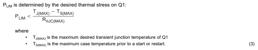

Dear Specialists,
My customer is considering TPS2491 and has a inquiry about formula(3) of datasheet P.12.
I would grateful if you could advise.
According to equation(3) of the datasheet,
Inquiry(1)
I cannot understand this formula
I think
Ts(max)/RθJC(max) < PLIM and Tj(max)/RθJC(max) > PLIM
transform the formula
Ts(max)/RθJC(max)<Tj(max)/RθJC(max)
PLIM : 0<(Tj(max)-Ts(max))/RθJC(max)
This is not correspond to formula(3), it seems to be typo.
Could you please let me know.
Inquiry(2)
TJ(max) is a junction temperature.
On the other hand, Ts(max) is a case temperature.
I think case temperature is not the same as junction temperature.
Could you please let me know why Ts(max) is used?
I appreciate your great help.

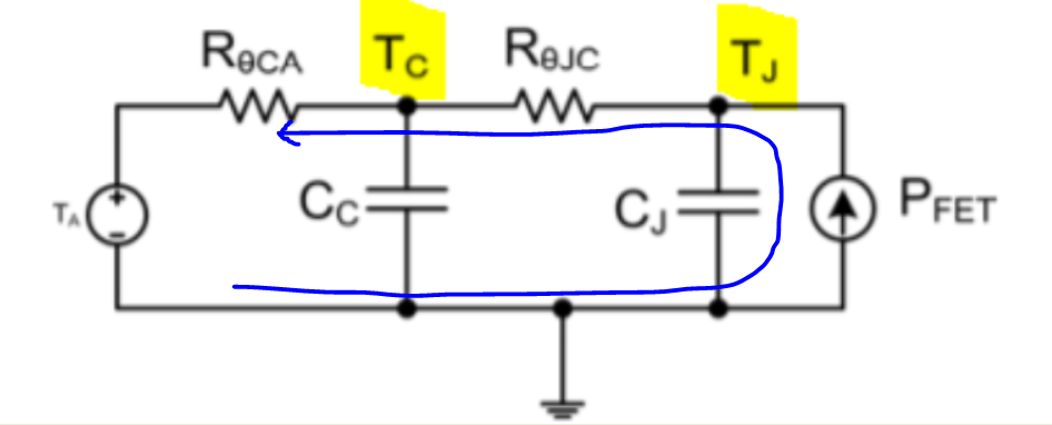

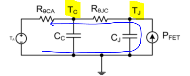

  • Hi Shinichi,
    TJ(max) is the junction temperature of the MOSFET
    Ts(max) or Tc(max) is the case temperature of the MOSFET
    As shown in the below simplified MOSFET thermal model, the PFET (=PLIM in this case) flows through the loop in steady state condition.
    For a given power stress across the FET (PLIM), the temperature rise above the case node can be calculated as follows.
    Temperature rise = TJ(max) - Ts(max)  = PLIM * RθJC(max)
    so PLIM = [ TJ(max) - Ts(max) ]  /  RθJC(max)
    BR, Rakesh
