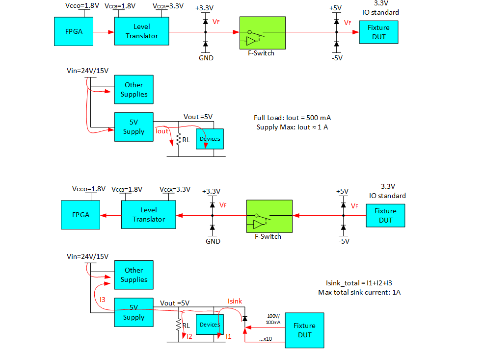

I want to find a bidirectional DC-DC converter with following requirements:
1: normal operation: 24V/15V to 5V/3.3V buck converter.
2: Sink current from output point: 5V/3.3V to 24V/15V. Max sink current is 1A.
For example: IO protection
Due to the high speed IO >50MHz, series current limit resistor is not feasible. The fixture is connected to an unknown external DUT. The overvoltage and overcurrent is 100V and 100mA.
Thus, we consider to clamp the voltage by the external current limit of 100mA.
But this concept required a stable 5V and 3.3V power supply.
The supplies should be able to sink the current from the DUT. The worst case is 10 IOs are used at the same time, therefore a maximum sink current is 1A.
The load of the supplies is not enough to sink this current.
Do you have such a power supply that can be bidirectional to sink this current and match the above requirements?

    1: For normal operation: the load current requirements is 1A.
    2: The worst case of the unknown DUT is 100V and 100mA. It's possible up to 100V, but it also has an external current limit of 100mA.
        As you can find in the schematic, the IO voltage will be clamped by 5V+Vf, Vf is the clamping voltage of the diode (@100mA).
        The current will be absorbed to the devices and loads of 5V supplies. If the sink current is too high, it will charge up the +5V rail up to 100V.
        If we can absorbed this current, we can provide a stable +5V supply. And the IO voltage will be clamped at 6V to protect the 100V risk.

    1. As shown in the schematic, BAV99 is used. The current is limit by the external DUT given as 100mA. It can be a big voltage drop on the BAV99, but due to the current is only 100mA. the voltage will goes down quickly. There will be a spike when apply a 100V/100mA limitation input to the forward clamping circuit.
    2.If I am correct, buck converter can be used in a fault condition. Vout will be higher than Vin, and the current will go through FETs body diode. And I only need to design a 15V to 3.3V DC/DC, and make sure the body diode can handle enough current.
    3.Can I add external Schottky diode between the VIN and SW, maybe more to make sure the current from the Vout can be discharge to VIN?
