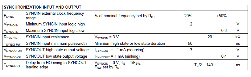

My customer is utilizing SYNCOUT function on LM5145. They are asking the
specification of it at this time.
1. SYNCOUT Output Volatge.
a)The datasheet is defined min. 3V, but real voltage  is not clear.
   Please let me know how to calculate maximum SYNCOUT volatge.
b)If above voltage is depended on the source/sink current, Please clarify the
  correlation chart SYNCOUT volatge & Source/sink current.
2. SYNCOUT Duty.
a)Please clarify the min. & max duty of SYNCOUT signal.
Please give your advice.

    SYNCOUT can only pull up to approximately the internal VDD voltage, which is loosely regulated to 5V.
    With no SYNCIN applied, the SYNCOUT duty cycle is always 50%.  It’s just shifted in time by ~140ns. With SYNCIN applied, the SYNCOUT duty cycle will be lower depending on the SYNCIN frequency.

    My customer is using LM5145 with external Sync(SYNCIN) = 425 ~ 500kHz, around 50% duty.
    And LM5145's SYNCOUT is provided to following LM5175-Q1.
    Now, they are checking the validness of their design. So, I would like to make sure more deeply.
    Please give your advice, again.
    1. You mentioned that "SYNCOUT can only pull up to approximately the internal VDD voltage, which is loosely regulated to 5V.".
        Following LM5175-Q1 has the peak signal limit as 3.3V. Is it possible to clarify the range of SYNCOUT voltage?
    2. They are using SYNCIN = 425 ~ 500kHz, around 50% duty.
        Is it possible to clarify CYNCOUT duty accuracy under this condition?

    The value of the RT resistor for the LM5145 is important. If the SYNCIN frequency is close to the free-running oscillator frequency, then the SYNCOUT signal will be 50% duty cycle. Also, the SYNCOUT signal amplitude will be 5V, so this should be considered when interfacing to the LM5175-Q1 buck-boost controller.
