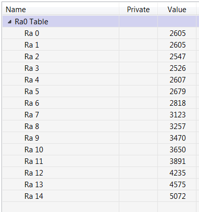

  • Jaga,
    I think a few things might be happening here.
    First, lets start with the SOH_MERIT that is being triggered. This bit sets when the EOS algorithm fails due to a negative value in the math. The most common reason for this is when GE goes high the gauge takes what is assumed to be an OCV voltage measurement. From there the time it takes to issue the "Gauge start" command if the battery is not relaxed and a higher voltage is detected the algortihm falls down because you cant have a higher voltage than OCV without chg current. I suspect there is not a sufficient rest period between the pulses and the voltage is still relaxing back up in the positive direction. A "hacky" way around this is to enable a small load to keep the voltage from increasing during this phase. You will want this current load as small as possible.
    Second, lets look at the measured impedance and scaled impedance.  I see the first 11 pulses are the value meaning on the 11th pulse you learn the scale factor. until the scale factor is learned the measuredZ will be used to correlate to the Ra table. The values around 4K put the expected SOH at grid 11/12 which represents close to 10% SOH remaining. After the scale factor is learned you drop the the 2500 Range which is full. This means there is some added resistance/cell to cell variation for your setup (which is the intent of Scale Factor). I suggest manually writing [State of Health] in Datamemory (address 0x4209) back to 100% after the scale factor is learned. I would not issue the "new battery command" because that will set the scale factor back to unleanred.
    Ra Table
    Lastly, Some early ID's had a complication with the OCV table. Please set the Cell Terminate Voltage to 900mV. There is a boolean check in the firmware to enable the smooth to 0 function and with the TermV above 1000mV it is always triggered. This forces the gauge to drop SOH by max delta every time
    If you have any further questions please let me know
