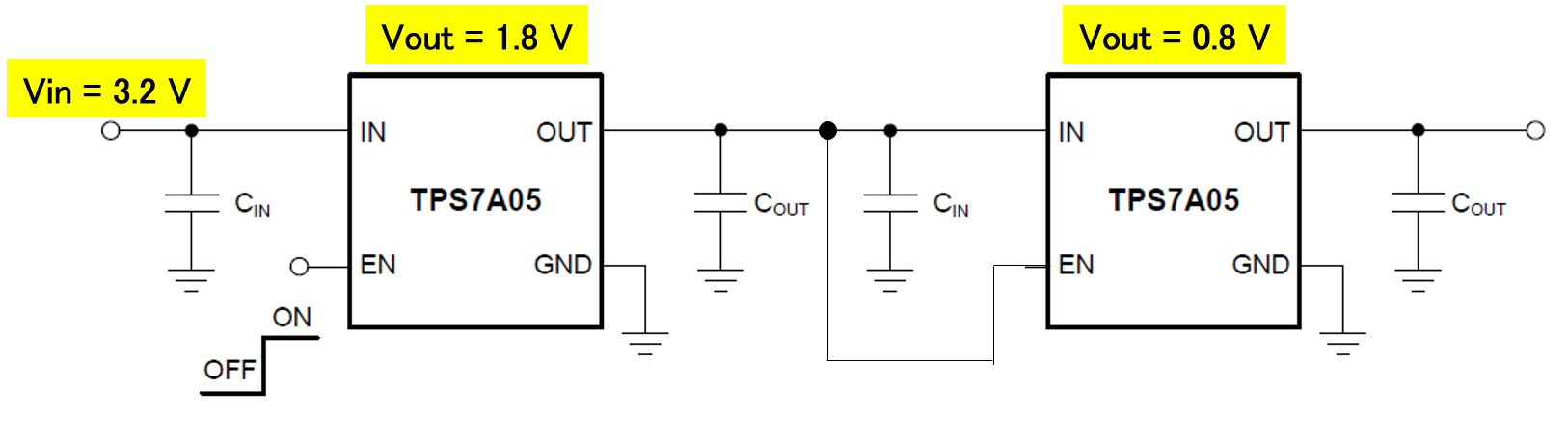

I use TPS7A05 series following conditions.
TPS7A0518 : Vin : 3.2 V
                      Vout : 1.8V
                      Cin&Cout : 1 uF ± 20%
                      EN is separate with Vin
                      Tj : -10 ~ 70 ℃
TPS7A0508 : Vin : 1.8V
                      Vout : 0.8V
                      EN = Vin
                      Tj : -10 ~ 70 ℃

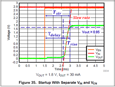

Let me know about "Start-up time" in these conditions.

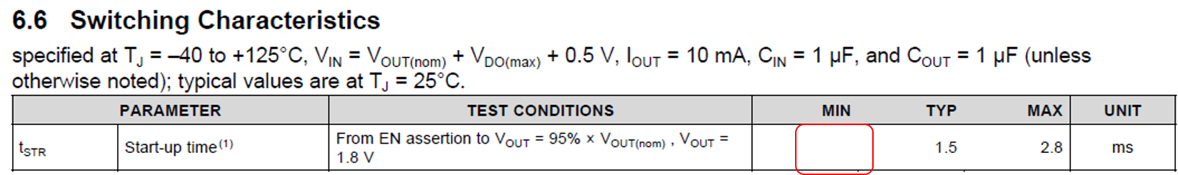

①Minimum value of "Start-up time"
②As figure 35, When difining Tstr = Tdelay + Trise, which region fluctuate when "Start-up time" fluctuate ? "Tdelay" or "Trise" or Both ?
if "Tdelay" fluctuate, I have no problems.
if "Trise" fluctuate, I must satisfy "Slew rate of Vout"(red dot line in Figure 35) < 0.018 V /us.

    We don't test for the minimum startup time in our production test which is why we do not state a minimum in the datasheet. That being said, I look at our test data and The minimum time seen is EN assertion to VOUT=95%*1.8V is 1.17ms. For 0.8V, the fastest start-up time we saw was 1.33ms.
    What is the application and what is the concern over the minimum start-up time? The reason we show the maximum is because, after this time, we guarantee that the device is enabled. The minimum time shows the fastest it could be enabled.

    I concern about "Slew rate of Vout".
    Because of requests of load, Vout must rise slowly( slew rate < 0.018 V/us ).
    As figure 35, When defining Tstr = Tdelay + Trise, which region fluctuate? "Tdelay" or "Trise" or Both ?
    If fluctuation of Tstr means that of Tdelay, I have no problems in terms of "Slew rate of Vout".
    However, if Trise fluctuate, I must consider about it.

    To control the slew rate you need an LDO with a Soft-Start Function. Does the second LDO need to be a really low IQ LDO? If Not, something like the TPS7A90 would help to control the slew rate.
