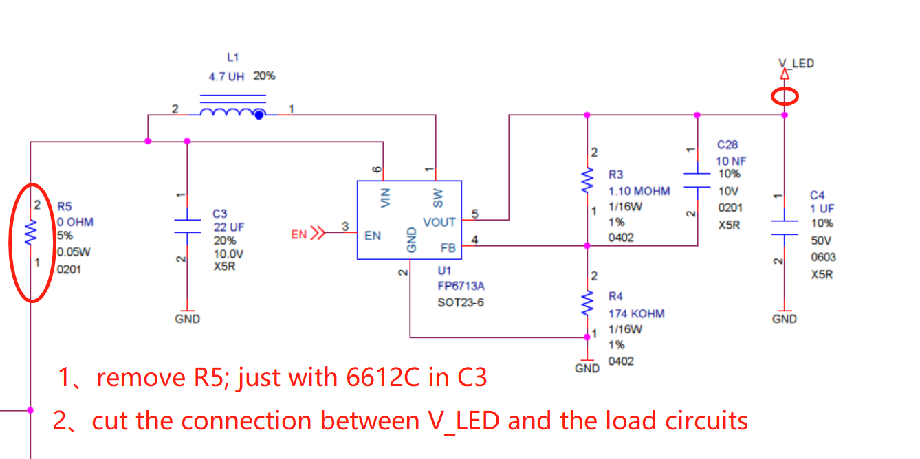

Hi:
In my project, there is a test item for current leakage when TLV61220 is disable by put en=0;
when Vin=3.2V; current leakage=4uA
when Vin=3.1V; current leakage=9uA
when Vin=3.04V; current leakage=10.3uA
when Vin=3.0V; current leakage=7.8uA
when Vin=2.8V; current leakage=3.5uA
It seems not so good as experted;
1、current leakage is bigger than described in datasheet;
2、why there is a bigger current leakage in especial voltage like 3.04V?
 I'd like to show you my design;
