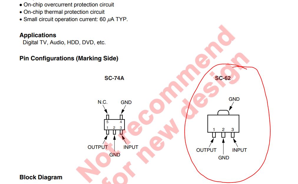

Do we have a LDO pin to pin with UPD120N25T1B SO-62 package?

Hi James,
This SC-62 package is actually the SOT-89 standard package. Unfortunately TI does not have a 2.5V output device in this package today. The closest device we have is our TLV73325PDBVR. This is a very similar device albeit in a smaller, leaded package:
GPN | uPD120N | TLV733P |
AEC Q100 | NO | NO |
Output Options | Fixed Output | Fixed Output |
Iout (Max) (A) | 0.3 | 0.3 |
Vin (Max) (V) | 5.5 | 5.5 |
Vin (Min) (V) | 3 | 1.4 |
Vout (Max) (V) | 3.3 | 3.3 |
Vout (Min) (V) | 1.8 | 1 |
Enable | NO | YES |
Power Good | NO | NO |
Output Capacitor Type | Ceramic | Cap Free, Ceramic |
PSRR @ 100KHz (dB) | 40 | 28 |
Noise (uVrms) | 120 | 120 |
Accuracy (%) | 2 | 1.4 |
Vdo (Typ) (mV) | 1000 | 122 |
Iq (Typ) (mA) | 0.06 | 0.034 |
Package Type | SOT-23, SOT-89 | SOT-23, X2SON |
