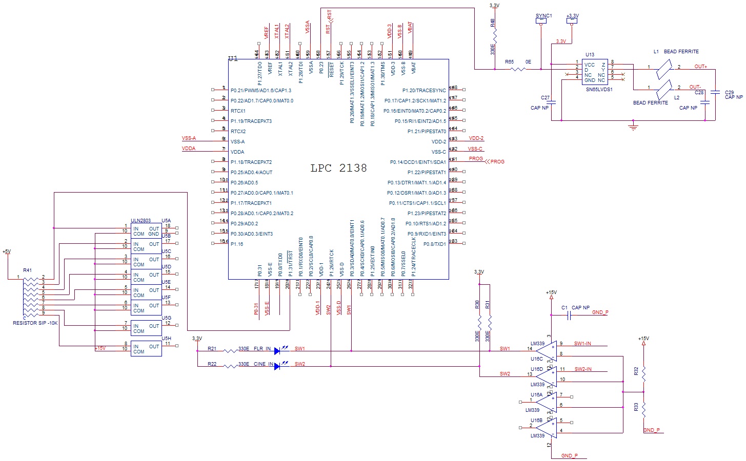

I have query regarding source & sink current of ULN2803 IC at input pin side. I am interfacing this IC with LPC2138 Micro controller  having 4 mA souce & sink current( operating gat 3.3 V) . Please suggest input current requirement of this ICs.
SO that this IC can be interface with LPC2138 safely.
  • As i Am interacting ULN2803 IC with LPC2138 MCU. Pins of Microcontroller goes into permanently  low level stage. Please suggest .
    LPC2138  ------------> ULN2802 IC

  • Hello
    LPC2138 Microcontroller has 4 mA source & sink current. As per your reply. ULN2803 has 0.93 mA requirement. SO lpc2138 can easily provide desired current as per requirement of iC without overloading.
    But I am not understanding why LPC2138 MCU pin goes to permanently low stage (i.e. fails) after using circuit in 1-2 months.
    I have upload circuit.
    Please suggest.
  • Hi Jitender,
    Apologies for the delay here. So just to be sure, the device works normally (switches on/off) for the first 1-2 months, but then after this time the IN1 pin can no longer be pulled high. Is this correct?
    If so, I have a few questions to help come up with a conclusion here:
    1. Do you know how much current the ULN2003A is pulling when IN1 is brought high after it fails?
    2. Does swapping the ULN2003A unit with a replacement solve the issue?
    3. How high are the current loads on the outputs of the ULN2003A?
    Alek Kaknevicius
