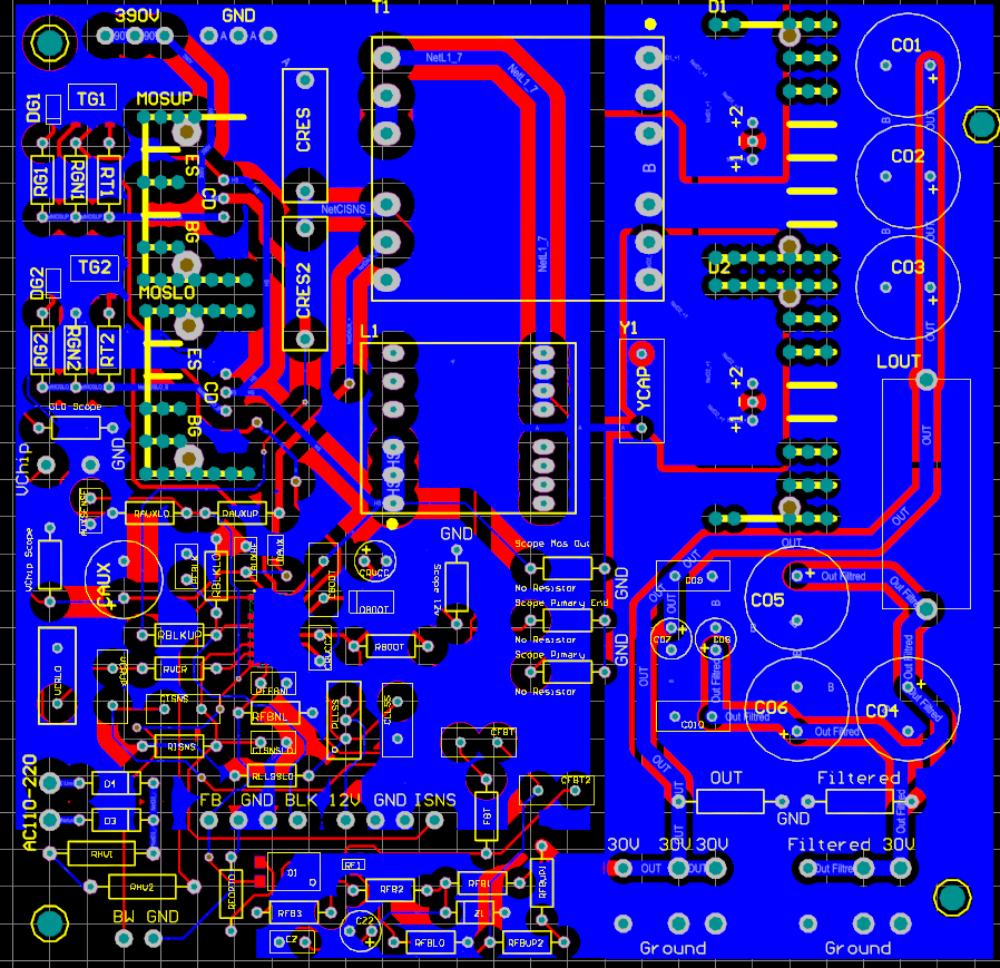

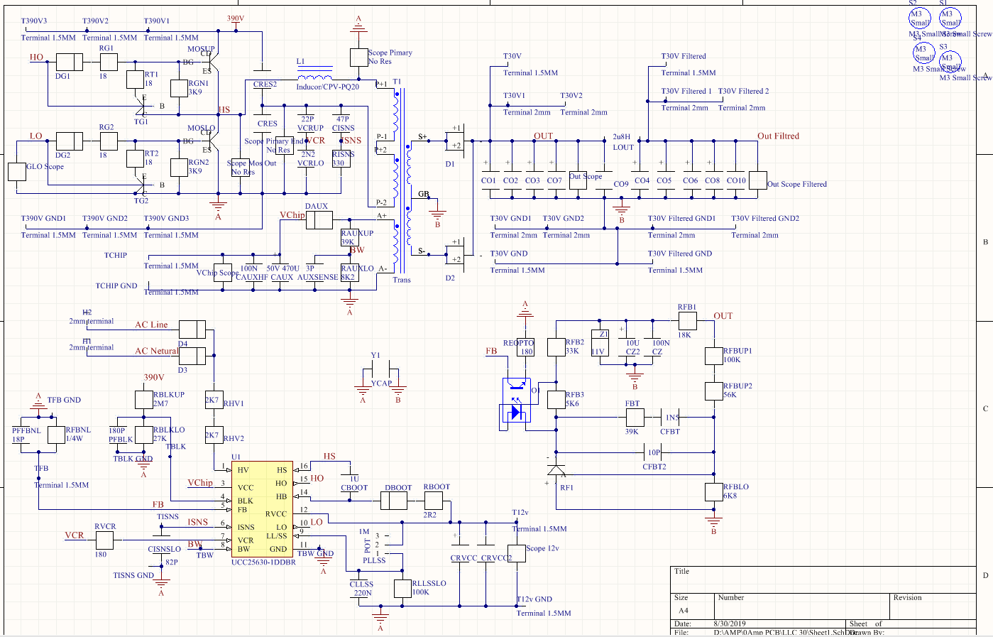

When input 230v AC and 390v DC input to the system it draws arround 13mA from the 390V.
However no VCC voltage is genereated when AC is pluged in , the VCC voltage stays at less than 0.2V.
The BLK voltage is 1V with the 2M7 upper and 27k lower resitor divider, 390v input. With not working HV startip function
With the 1.2M and 56K lower resistor I got 2.8V BLK and 1.5V at the VCC pin, I'm guessing VCC is being charged by BLK pin.
Can someone please tell me the prolbem.

Is it because the PFC has to turn on before the LLC  can start and I need to change to a UCC256302 chip. Which I think unlikley

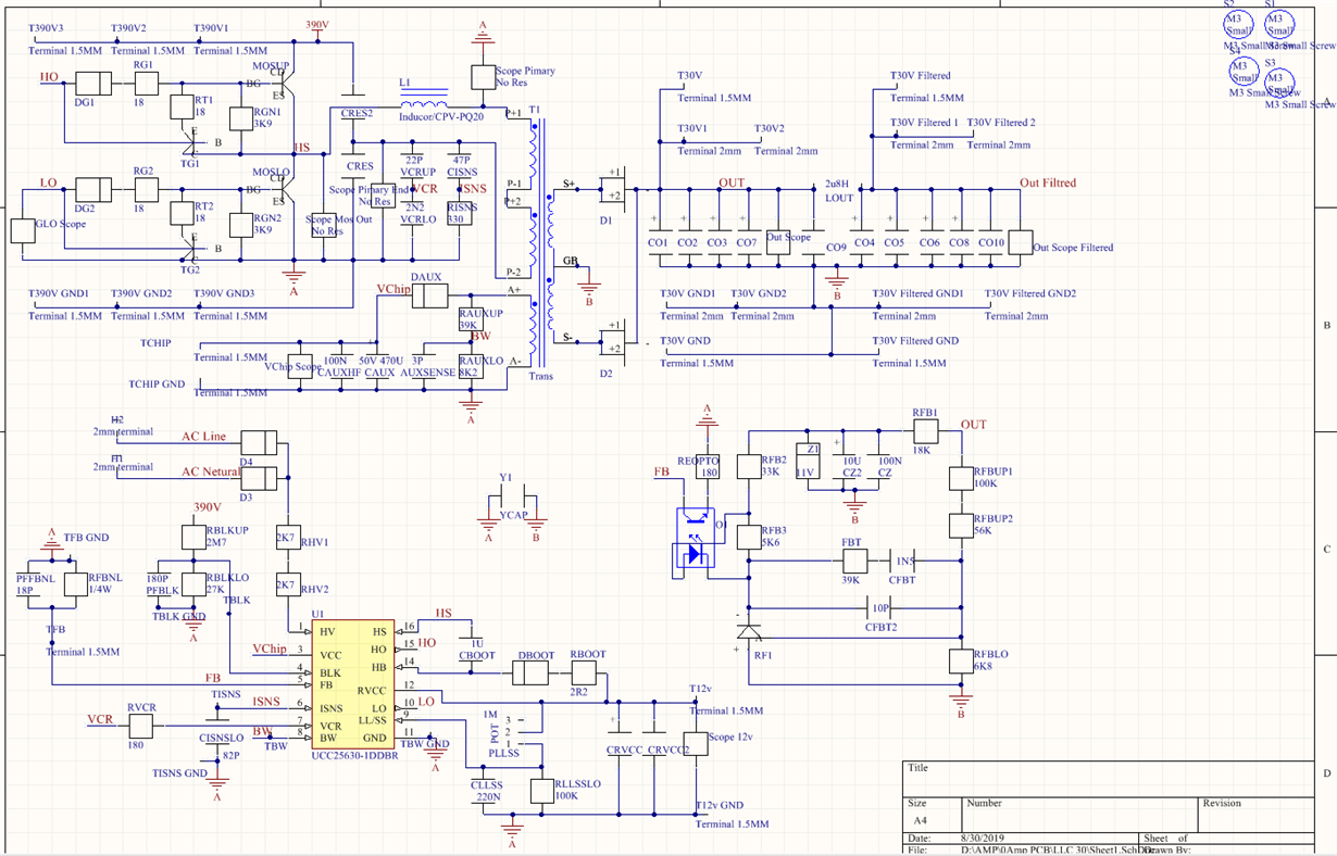

Or is it becasue the system requires the external circuitry on the 230V which I do not have, I only have two diodes and two 1/2W resistor feeding to HV pin from 230v AC.

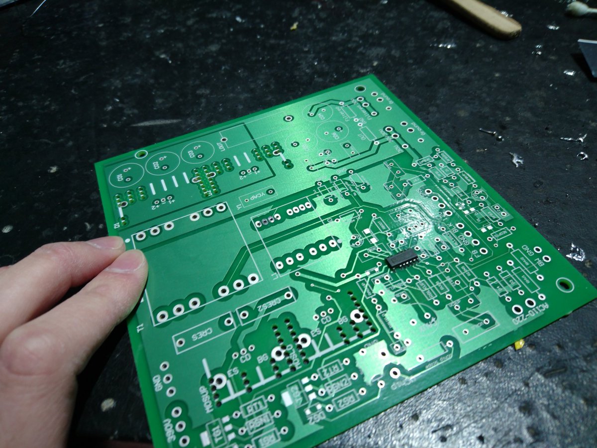

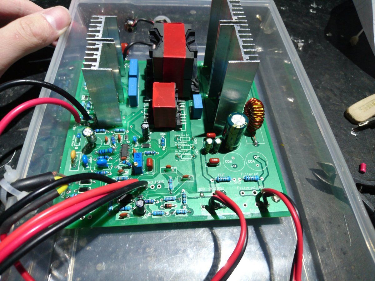

1st time I thoguht I damaged the device through ESD and soldering too hot manually.
Used a pick n place SMD machine and proper SMD oven to get the whole thing rebuilt
Also used moderate ammounts of ESD precautions with anitsatic wrist bands, mat and connecting GND of LLC to Mains via 1M when installing.
After rebuld still dosen't work.

    How did you design your board?  We recommend that you use our excel design calculator http://www.ti.com/lit/zip/sluc634 to verify that there are no errors in your design.
    My understanding is that the trouble you are having is that the bias VCC voltage is not being generated.  If you are not sure which variant of UCC25630x to use please review the following selection guide to make sure the variant you are using includes the features you are looking for http://www.ti.com/lit/sg/slyt728/slyt728.pdf.  If you don't need x-capacitor discharge function we recommend you switch to UCC256302 or UCC256303
    The way that the self bias startup for UCC256301 works is that the HV pin acts as a current source to charge the VCC capacitor up to the enable threshold.  This is explained in section 7.4.2 (page 32) of the datasheet.  In your schematic it appears that HV pin is connected to AC line and neutral, so you must have an source connected to the AC terminals for it to startup.  If you are applying a voltage there and you do not have a voltage increasing on VCC, I recommend you verify that the AC input voltage is making it to the IC.

  • I only have the basic swithing principles, at uni they don't offfer any advanced courses. Since the PHD project supervisor has litte exprience with optocouppler design and zero exprience with LLC design, I ended up learning using online materials.
    I designed the board using HV traning guide from TI, PDF files on LLC tutorial design on semi, infineon, TI. Also using all the tehcnical documents provided for the UCC256301 chip.
    I used the spread sheet to design the schematic, but also used formulas to calculate and verify that the transformer design is correct. I have a confidence level of 100% working before I started creating a PCB. I also created a list of VCR capacitors to use, so the transient response can be fine tuned. I coppied the optocoupler design from webench and going to fine tune the actuall values for transient response. I also have looked at opto design guides however it requires measuring of the actuall system operating and working to get the values calculated, so I'm doing trial and error instead.
    My understanding of the VCC voltage from datasheet and design guidelines.
    Is that only 2 diodes from ac and a resistor connected to HV pin, and connecting the IC to GND and providing a VCC capacitor is that only reqired to generate a VCC voltage. Regardless of whats going on in otherparts of circut.
    Once the VCC voltage is generated from AC input, the controller will detect if theres any fault conditon, if not then the chip will start switching.
    Otherwise is there any extra circuitry reqruired that is not mentoned in the datasheet.
    Can someone please confirm or tell me the connecteion for the VCC generateion from AC input.

    1st time installing the IC chip soldered by hand and was fairly quick to not overheat it.
    2nd time ESD precautions and proper SMD installation mehtods was used.
    Is the UCC25630x ICS very senstitive to ESD and or requrie a custom baking temeprature profile to get it working. The standard baking profile was used and it expriences max temp of 250C ramping from 200C in 30s and ramping down back to 200C in 30s. I don't have the actuall temperatiure profile on me but I can get it if it helps.

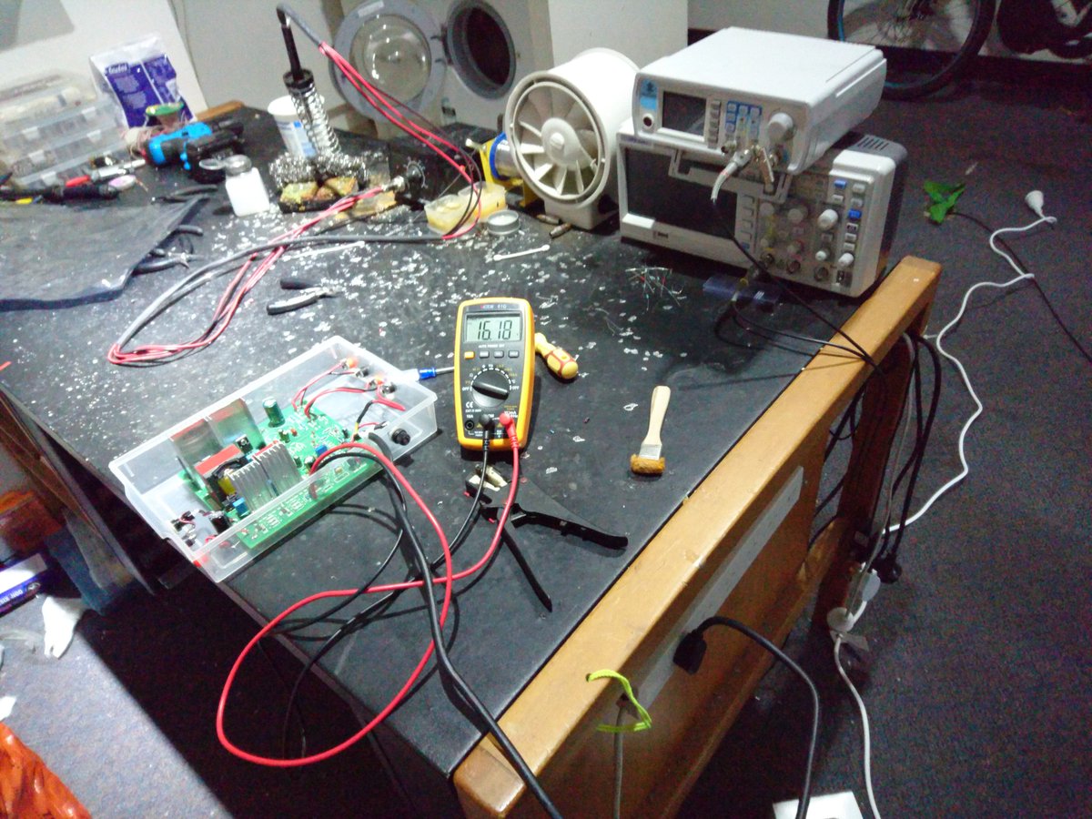

    I have confirmed there is ac input by measuring 230V AC at the diodes input on the PCB, however I have not checked the ciurrent at all into the HV resistors since I don't see how this will help.
    I also had measured the capacitance from HV pin to GND on the controller IC pad when the IC is removed, the capacitance is about 20pF with a moderate accuracy capacitance meter.

    As for your question on how VCC is generated, it works by having the HV pin act as a high voltage current source that charges VCC.  In UCC256301 there is a FET that is configured to act as a current source, so when a voltage is applied to it, it will provide a charging current for VCC.  Once VCC reaches the UVLO turn on threshold, the FET is turned off, disabling the current source and UCC256301 is enabled.  The switching action will cause the aux winding to generate the VCC power that will drive UCC256301.  If you do not have any voltage on VCC, we recommend that you verify that there is a voltage being applied to HV pin.  If there is and VCC is still not coming up, we recommend you verify that there is no short (such as failed component or solder bridge) that is holding VCC to GND.

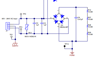

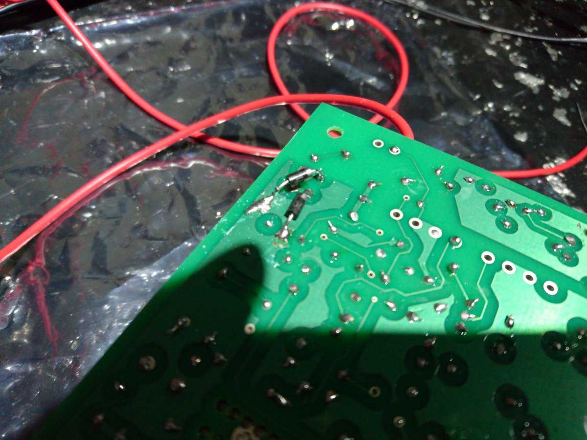

    I had to add two extra diodes from AC input to ground of the IC chip, right behind the board where the diodes feeding HV pin are. The refrence design has a full bridge rectifier with small capacitor load to allow the evaluation of the X cap discharge function.
    The negative part of the fullbridge rectifier which is also connected to IC ground acts as a return path.
    In the schematic I have, there wasn't any return path. No voltage loop is formed so nothing will happen.
    I had only two diodes feeding the HV pin which is what the TI data sheet typicall schematic shows, it also dosen't emphasise or mention at all that a return path must be avalible to generate the VCC from HV pin.
    For the actuall schematic I belive that two diodes from AC mains to ground of IC should be removed, because these may be acting as parallel connected to the full bridge rectifier negative part which feeds the PFC, it can be loaded up when the PFC draws power and may burn.
