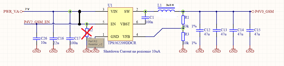

TPS562209: power consumption at no load
Expert 6460 points
Part Number: TPS562209
Other Parts Discussed in Thread: TPS562201
Team,
we observed a high power consumption of the converter (12mA) at no load (Vout=4V; Vin=7V). We'd expect max 1mA.
Can you advise if the schematic is fine?
We can take into account a different TI device as well.
