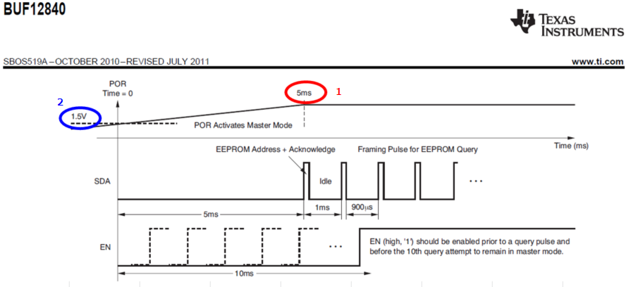

Hi, Time,
Could you please let me know the (Min./Typ./Max.) spec of the attached 1 and 2?

I have notified our expert regarding this topic. Please expect a response by 9/5/19.
Aaron
Since the communication is asynchronous the 5mS delay is not a critical system timing. The expected tolerances are similar to the master mode clock - <+/-20%
