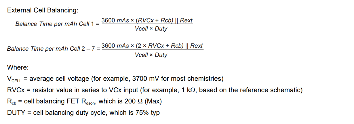

I have many questions about to calculate the Balance Time per mAh cellx
What is the signification of "||" ?
RCVx, Rext and Rcb are in Ohms?
Vcell are in mV?
I've measured a 45% of duty cycle, should I use this value?
Loïc
