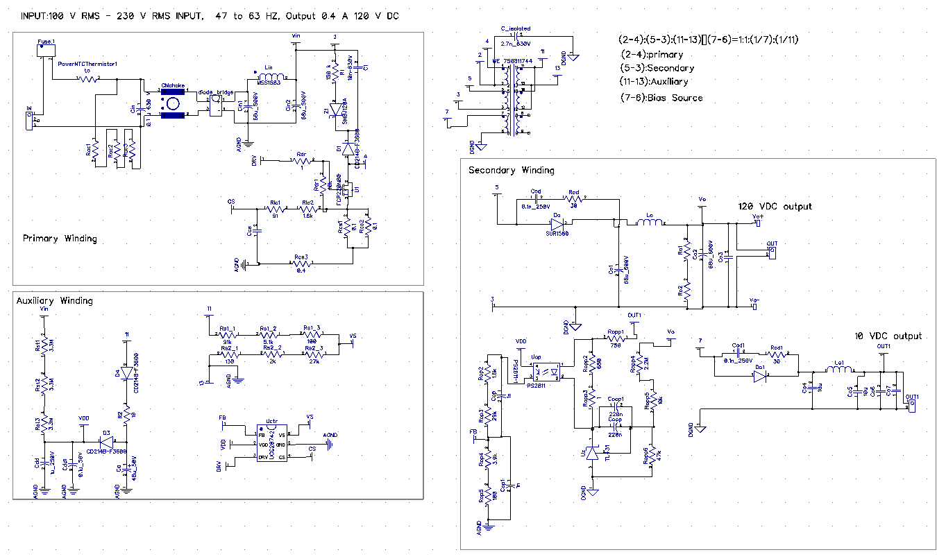

This is my schematic. I'd like to generate a 120 V dc output voltage and one around 10 V dc output voltage. With 110 AC, 50 Hz input,  VDD pin of UC28742 has a Sawtooth Wave (lowest value around 8 V, highest value around 21 V, frequency around 23 kHz). However, the DRV pin of UC28742 has no output. Is anybody has an idea about this issue?
Thank you for your help.
Ying
