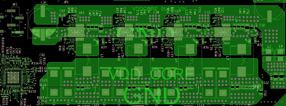

Hi E2E,
RD used TPS53667+CSD95490 to design before, the layout as below,
They want to improve and less layout area, Could you provide the suggestions?
Thanks!
Hi E2E,
Thanks!
Hi Julian,
They can refer to TPS53667 EVM to put bulk cap on the bottom side and some of the input caps on the bottom side as well to save space. (the 3300pF input cap need to be on top side).
