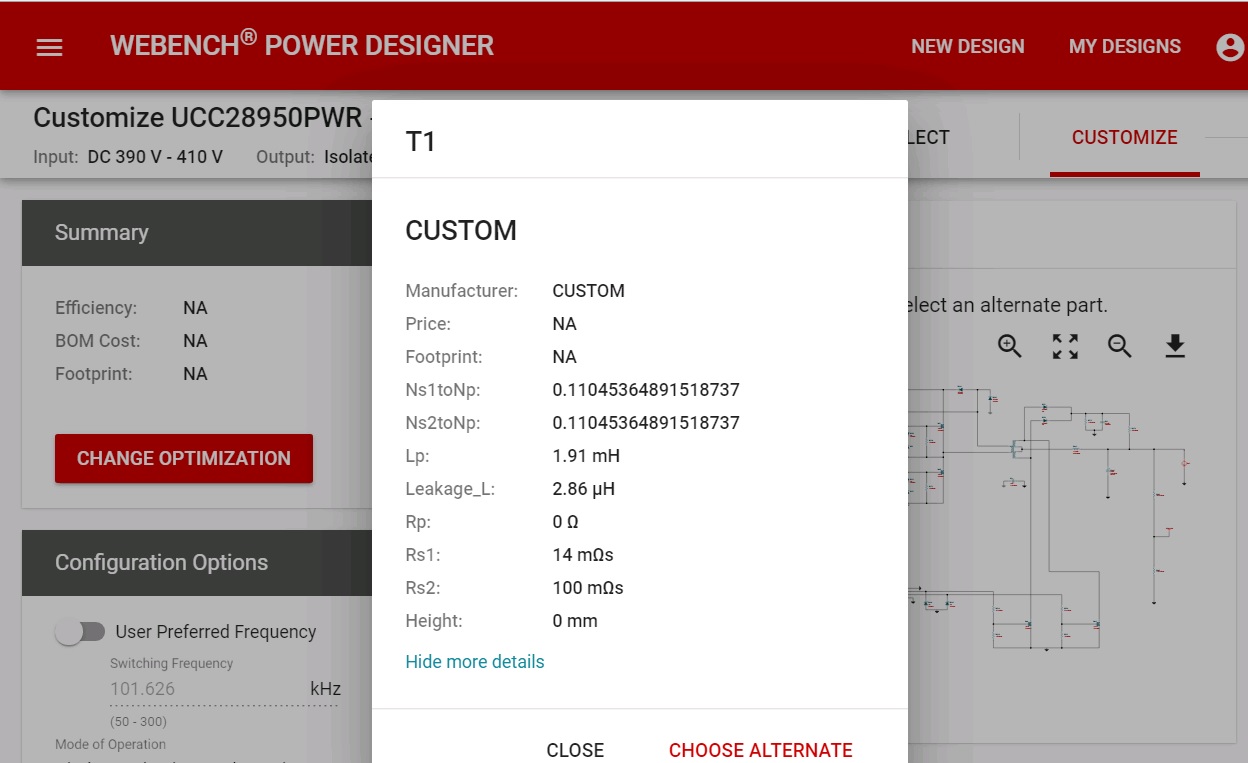

    The transformer numbers do seem odd and I cannot access any information on the transformer design from the file that you sent me. Where did the 390/40 turns count come from ? The minimum input operating voltage will also impact the turns ratio.
    Can you take a screen shot of the transformer details from webench and post it?

    The transformer specifications are listed by webench tool itself (So based on 390*0.110 = 42V, I have arrived at conclusion that the transformer is giving 40V at each secondary winding with respect to the ground).

    The peak winding voltage will be 40V but the operational duty cycle at 390V will be closer to 70% , 28V/40V. Which sounds about right.
