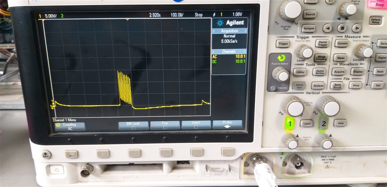

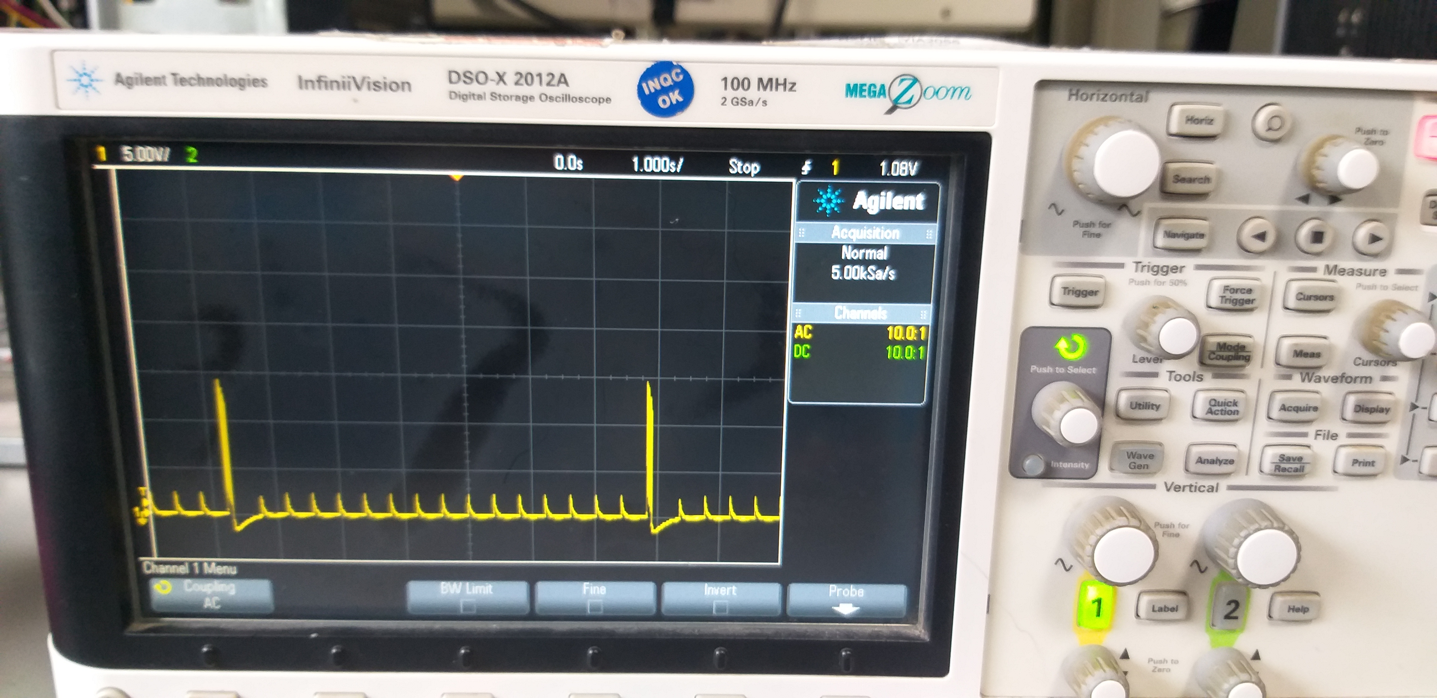

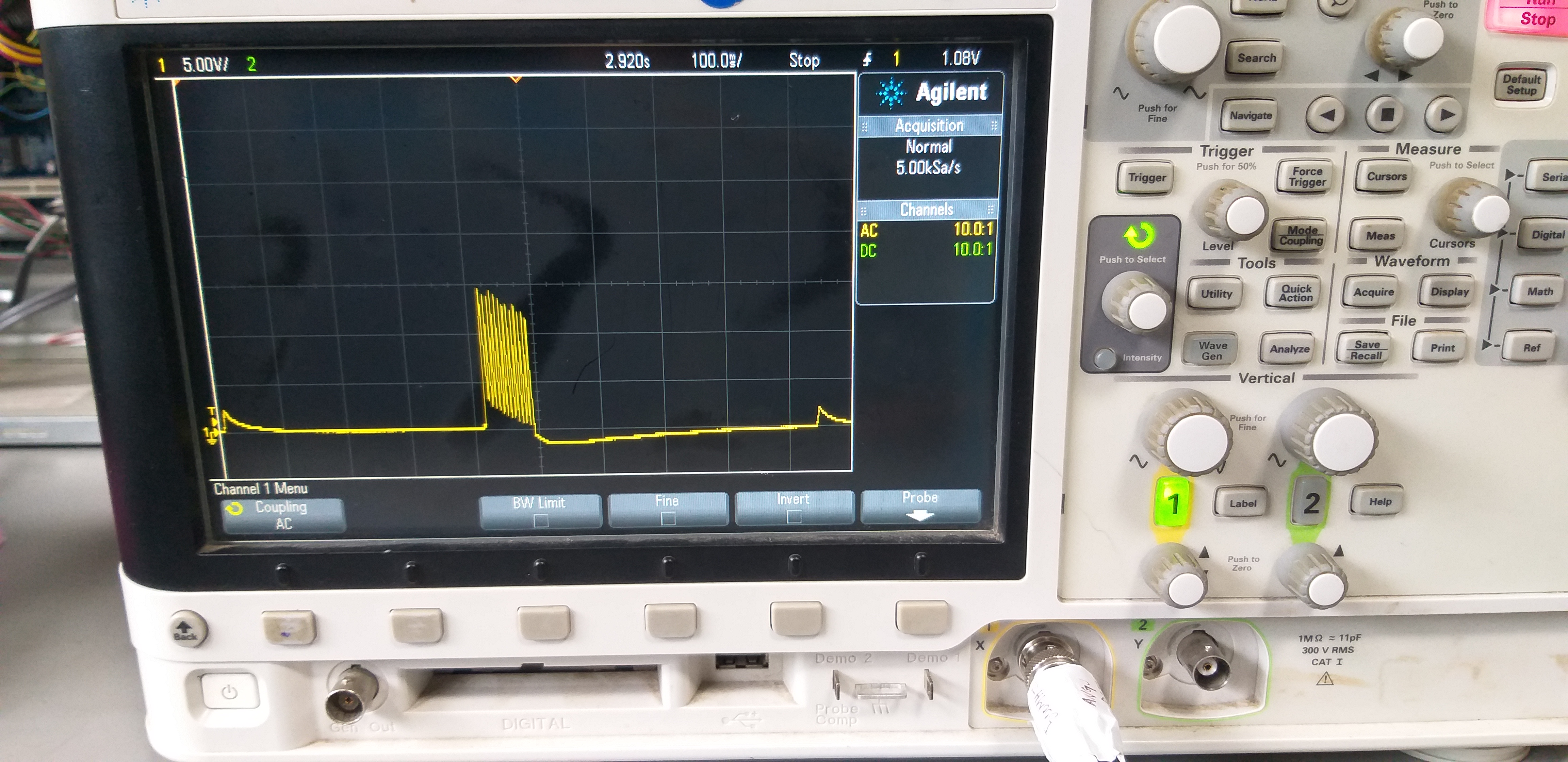

    Attached the RECT output waveforms during the non-charging condition.
  • It looks like the voltage at RECT is getting high enough, should be greater than 2.7V to start.  But it also looks like it may be too high max is 15V, OVP point.
    What value of Cs tuning caps are you using?  Also Comm cap value?
    Ls = 28uH (Approx.) & Ls' = 35uH (measured with Ferrite sheet stuck behind the coil). Cs --> C1  = 0.067uF (series first resonant cap) &  C2 = 890pF (parallel resonant cap). COMM 1 = 0.022uF (50V) & COMM 2 = 0.022uF (50V).
    Suppose if RECT voltage is too high our inductance value should be high. Any suggestion for reducing the magnetic coupling?.
    The behavior is depending on the distance b/w receiver coil and primary coil as if I am maintaining a gap of greater than 3mm charging will suddenly start.
    Hafiz
