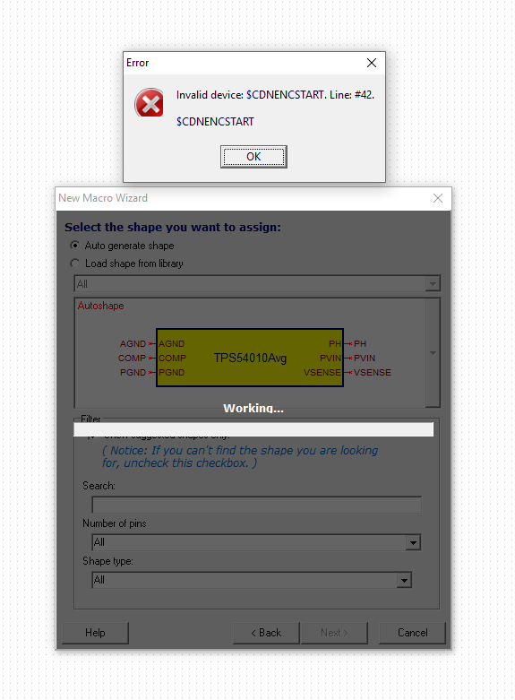

I found the TPS54010 pspice model on TI website. How do I import it into TINA-TI?

Hi HC,
please have a look the the following training video as I think it might already answer your question:
https://training.ti.com/importing-spice-models-tina-titm-simulator
Please let me know in case you need further help on this question afterwards.

Hi HC,
Thanks for your feedback. The error message indicates that the model is encrypted. Let me request an unencrypted model so that you can use it in TINA-TI. I will do so and let you know about the schedule when I have more information.

Hi HC,
I have request an unencrypted model after my last post and the team has added it to their pipe of model.
I asked for the expected timeline and will come back to you when I received more information.

Hi HC,
unfortunately the model is still in work.
I would suggest to close this thread in the meantime and come back to you when the model is ready.
