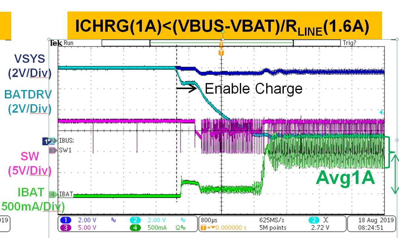

  • Hi Akihisa:
        For Q1: Please confirm if customer input  source is adjustable.
                      We don't recommend to enable charge when in PTM if input voltage source is not adjustable. Especially given 12V fix input voltage and battery voltage is only 4V. Because when enable charge under PTM,the charge current should be (VBUS-VBAT)/RLINE(Rline is the distribution resistance from input voltage to battery terminal).The charge current( (VBUS-VBAT)/RLINE) will be increase fast when VBUS>> VBAT and trigger charge current limitation we set in register(ICHRG), then BQ25710 will switch back to buck boost mode the regulate the current average value to the charge current setting.  For example the waveform shown below. This just show the concept, for 12V/4V case it will be much worse I believe.
                      If input source is adjustable for flash charge, then story will be totally different.
                      We can't boost Battery voltage to system, but we can do OTG for the input side.
     For Q2:  Our 25710 is NVDC buck boost charger, which means the maximum system voltage is 180mV higher than battery fully charged voltage. You can consider BQ24780 for your application.
    Shishuo
