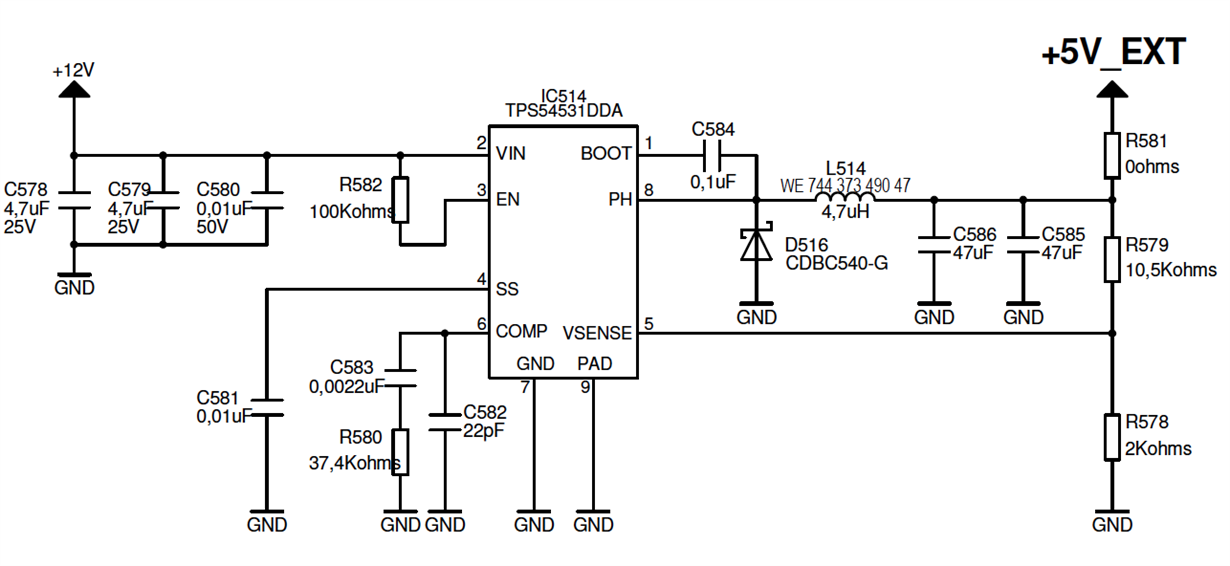

would you be so kind to review our schematics for the TPS54531 before we start the layout the PCB?
Thank you and best regards,
