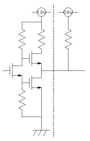

    I think that LDOA3 does not have ability of the Sink/Source.
    When the port is low, the 0.9V power is source, and when the port is high, the 0.9V power needs sink ability.
    Therefore, the power supply of VTT thinks that VTT LDO or external power is necessary.

  • Hi PAN-M,
    LDOA3 does not have sink/source capabilities. If you need sink/source for your design use VTT_LDO and you can use LDOA3 to replace VTT_LDO for VPS_MGTRAVCC.
