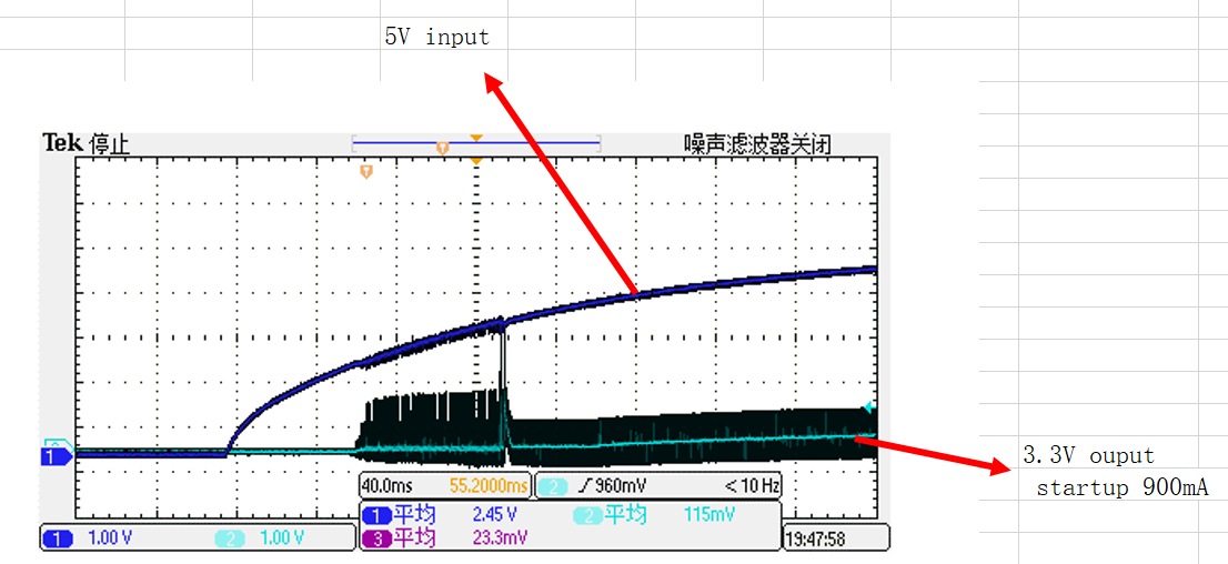

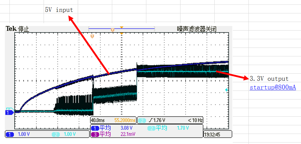

  • hi,Britta:
      thanks for your reply , below information may help you understand my issue :
    1. This morning  i use a electronic load instead of resistances ,this time loading 300mA  works well ( both in startup and after Vout ramp), i don't know what happy .
    2. i increase the load to 800mA ,it's also works well too(both in startup and after Vout ramp) ,see attached picture.
    3. but when i increase to 900mA ,the issue happy again.(load to900mA in startup ) ,see attached picture , it;s similar for this issue.
  • Hi Jianfeng,
    thanks for the details.
    Am I correct that now you only the issues at 900 mA load current? Can you confirm that also when you increase the load to 900 mA and above after Vout ramp? Did you see this issue on one device or multiple?
    I will try to also reproduce your measurements in the lab to understand what happens.
    Britta
  • Hi,Britta :
        In the early days , when I load in 300mA  ,the volatge droped down  ,but  no happen again in the next days . so i icreased the load current to 900mA , the issue appears again . The load 900mA is in start upatatsue not in vout ramp , i just use one chip for this demo board . i am looking forward for your test record ,thanKs!
