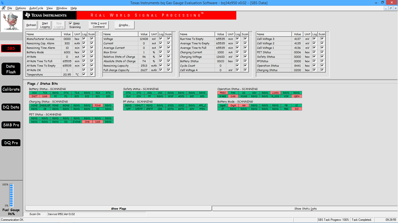

  • After programming  golden.senc file i sent reset command and then IT enable command.
    Chg and dsg bit are set. No PF. Its look like OK.
    But when I plug in the charger the current is zero. but the voltage is growing.  When I connect load bq34z950 loses connection until I connect the charger.
    Voltage of pack, voltage of every cell, temperature and so on are displayed correctly.but the current is zero anyway.

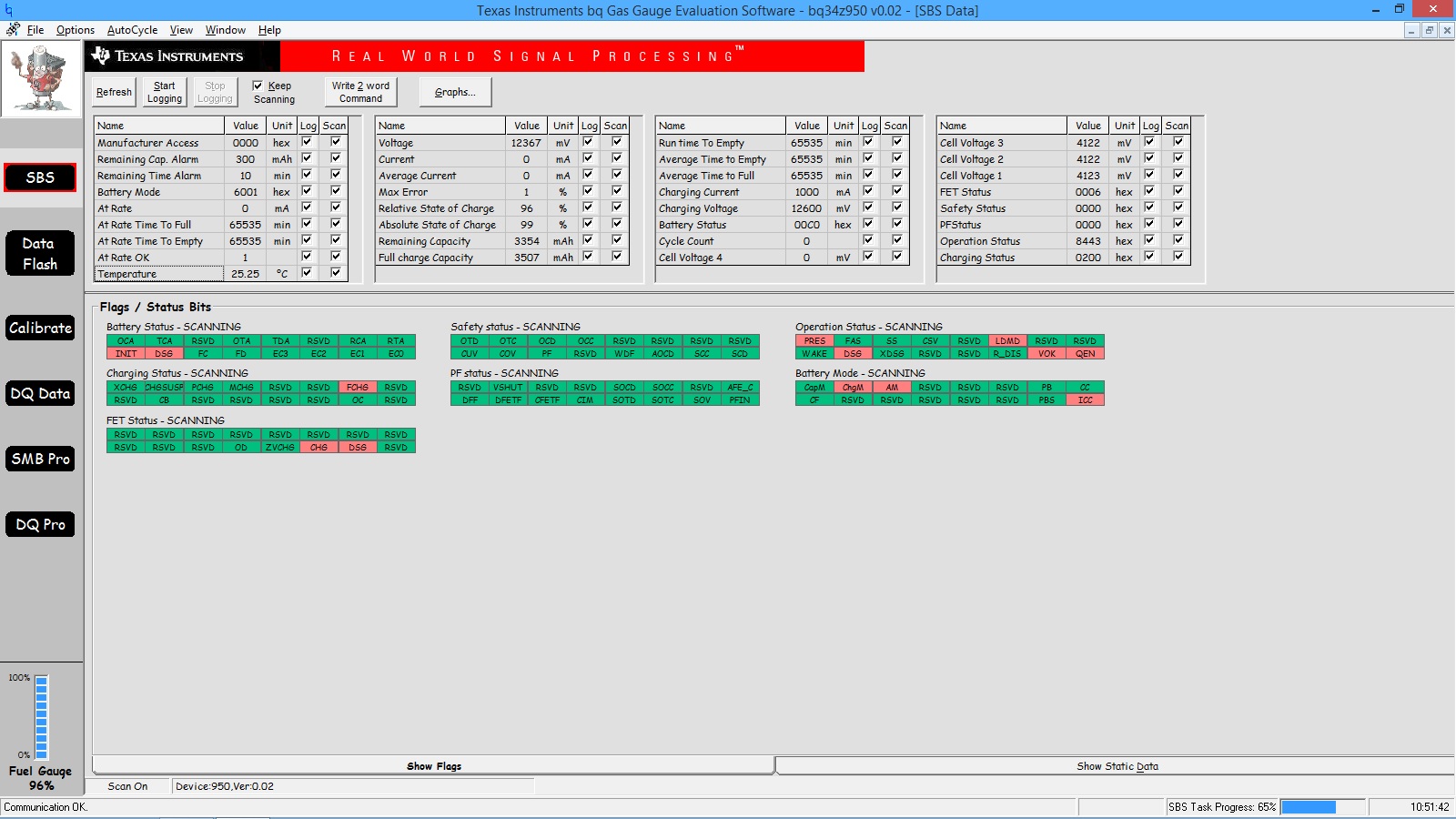

  • I forgot to write, I tried to programm back the default senc file, configure the basic settings (such as the number of cells) and after that the charge / discharge and current indication work correctly.
  • BQ with my Golden.senc file. The charger is now connected, the voltage rises and the current is zero

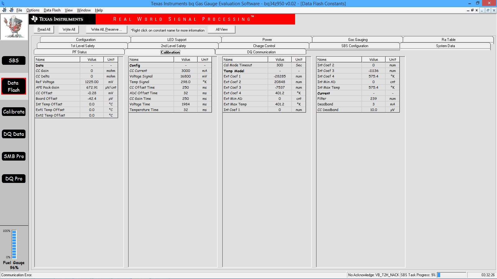

  • Hi Nikita,
    Please check your calibration section. See if the cc gain and any other values there have been zeroed out. If they have, you will need to perform calibration again and then import those values or write them manually into the gauge.

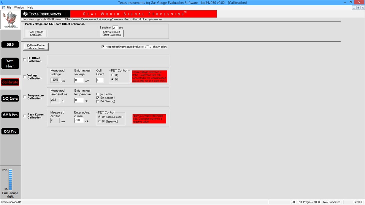

  • Hello!
    The truth is somewhere near!

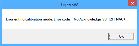

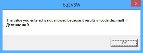

    When I trying to read cc gain and cc delta an error occurs (screenshot 2).  iIn the GG file on the basis of which golden.senc is made CC Gain = 10.674
    CC Delta = 10.674, but TRM defines the range for these values 0,1 - 4 for CC Gain and 29826 - 1193046 for CC Delta.
    I tried to do CC Offset Calibration and Software Board Offset Calibration.
    It did not help.
    Thank you for help!

  • Hello!
    I tried to do as you wrote.
    1.Enter ROM Mode (Write SMB Word 00 0F00)
    2.Programm Golden.senc file.
    3. Sent SMB Command 08
    4.Rerun bq EVSW

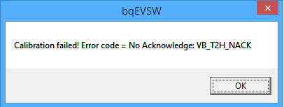

    5. Calibrate Software Board Offset  (OK)
    6. Tried to calibrate CC Offset (Error - Screenshot 1 & 2)
    7. despite the failure in the previous point, reinserted the cells and sent a reset command (0041)
    8 Waited 5 minutes/
    9. Sent IT enable (0021)
    10 Tried to charge - voltage rises, current is zero
    CC Gain and CC Delta in Data Flash screen are still zero.
    Nikita!

    Today I tried CC offset calibration. everything was OK, but  CC gain and  delta have not changed
     https://e2e.ti.com/cfs-file/__key/communityserver-discussions-components-files/196/gg_2600_senc.7z
  • Hi Nikita,
    Your cc gain and delta from the gg you exported are zero. Please reflash your fw.
    [Data(Calibration)]
    CC Gain = 0
    CC Delta = 0
    Ref Voltage = 1225.00
    AFE Pack Gain = 672.91
    CC Offset = -0.279
    Board Offset = -42.4
    Int Temp Offset = 0.0
    Ext1 Temp Offset = 0.0
    Ext2 Temp Offset = 0.0

  • Hello Batt!
    It seems to have helped.
    With one pack everything worked out.

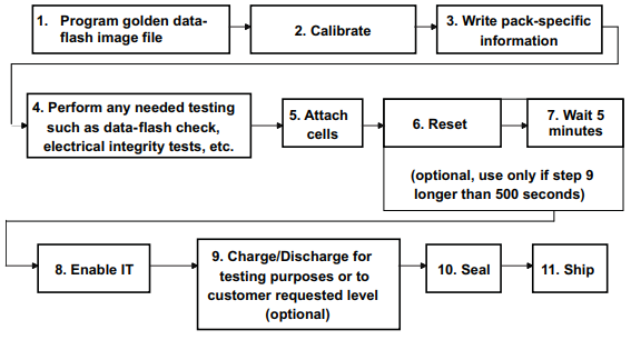

    I am trying to make the second with a new board guided by the scheme (screenshot).
    Is it necessary to do all calibrations? in particular, the Pack current calibration bothers me - 2 A is too much for my system (2 A is the current protection fault value).
    And also I again have a problem with calibrating the CC Offset calibratoin  as I wrote earlier  (point 6)
    What should i do with this problem?
    And in order to perform tests as in point 4 (the diagram in screenshot above) I need the chg and dsg fets to be open. Do I need to do this with the reset and IT enable commands?
    Thank you for your help!
    Nikita
  • Hi Nikita,
    You can calibrate the gauge with a 1A dsg. You can disable FETs with the IT enable command. Also you can use auto cc offset on init to make sure that the cc offset calibration works.
